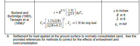

In a review of other references to the method, the equation you posted is incorrect.
The standard form I find is that q is in the numerator vs the denominator, the coefficient is 1.706 vs 1.6, and the exponent is 0.7 vs 0.75.
See eqn #15 in their paper:

I just came across this in UFC 3-220-10 (DM7.1):
