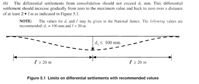

Regarding the settlement of flexible pipes , i will suggest you to look ;
- BS EN 1993-4-3,Design of steel structures - Part 4-3: Pipelines
- PIPELINE DESIGN and CONSTRUCTION , A Practical Approach by MOHITPOUR
- Buried Flexible Steel Pipe Design and Analysis (ASCE Manual No. 119 )
The following excerpt from BS EN 1993-4-3:
In case of rigid pipes, the joints should have some flexibility ( socket spigot with rubber gasket etc .) and short pieces should be provided at connections to structure ( manhole etc)..
Pipelines should not be placed in soil where settlement will cause overstress, nor pulling apart of joints. Unsuitable material should be removed and replaced with materials that provide support, compact granular fill, etc.
