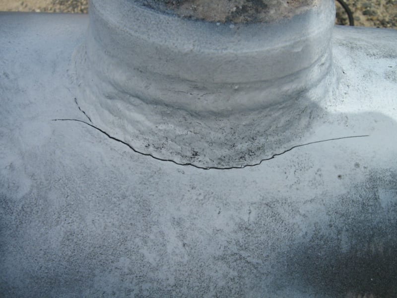

Be careful what you wish for. Weldolet welds can be quire large and can put a lot of heat in to the header pipe. For low pressure applications a boss could be better.
