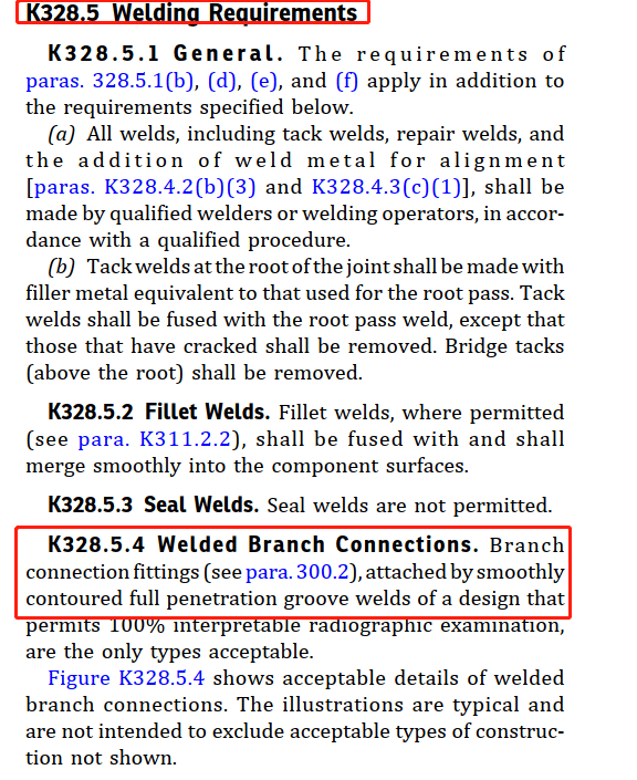

In our project, 2500# CS piping class,
3x2 and 4x2 branch fitting have selected Sweepolet, rather than Reducing Tee as per ASME B16.9, which is more common.
Really confused for the selection of bran fitting selection.
Anyone can help to figure out what's basis, and whether to go for sweepolet or can also select traditional Reducing Tee, and what is the basis

This is B31.3 High pressure designed class, see snapshot attached from ASME B31.3 Chap. IX. This ask for contoured branch fitting for welded branch connections. However, it's not saying that reducing Tee is not allowed.
Correct me if im wrong.

Branch fittings welded to the run pipe must be CJP but how to confirm ?
Volumetric testing of weldolets is nigh on impossible - RT is out and UT requires special procedures, generally only possible on large bore (or over a specific DN) and a huge amount of branch fittings are small bore.
Then I looked at a sweepolet - 100% radiography is possible.
Food for thought.

I tried to check with Bonny Forge ( which are the applications are more suitable for Sweepolet, only refers that " These drawbacks are of increasing concern when high yield pipe is used and for other critical service applications such as nuclear. On softer materials such as A106 Gr. A or Gr. B pipe, the localized areas of high stress tend to be relieved by local yielding and generally do not adversely affect the serviceability of the joint unless cyclic loading is involved or there is a propensity for brittle fracture"
It also refers the code complience. Code to be checked.

B31.3 300.2
branch connection fitting: an integrally reinforced fitting
welded to a run pipe and connected to a branch pipe by a
buttwelding, socket welding, threaded, or flanged joint;
includes a branch outlet fitting conforming to MSS SP-97.
Again IMHO - branch connections would include sweepolets, weldolets, thredolets, flangeolets etc

No evidence that Reducing Tee shall be used, just past experience, in 4x2 and 3x2 case.
Referring to fig. 328.5.4E another might be an extruded outlet. Fig 328.5.4E is referenced under 341.4.3. for severe cyclic conditions, so Im assuming (but maybe someone can confirm) that such a detail is acceptable for chap IX piping (note I wasnt able to find something in chap IX that prohibits 328.5.4E(b)).
