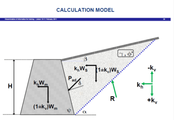

No...not really..Eurocode 8: Part 5 - 7.3.2.2 item 7 states 'For non-gravity walls, the effects of vertical acceleration may be neglected for the retaining structure.'. That is, it covers the mass of non-gravity wall only! which is negligible....The effects of vertical acceleration for the active soil and resisting passive soil shall not be neglected.. Remember Mononabe -Okabe formula,
Ed =(1/2) γ* (1 ± kv) K⋅H**2 + Ews + Ewd
The item ± kv covers vertical acc.effect.
The picture below depicts the calculation model for gravity retaining wall.. It is clear that , the vertical acceleration affects active soil wedge and wall mass.

Yes i see what you mean, you only neglect the vertical effect on the retaining structure but not on the active wedge.
