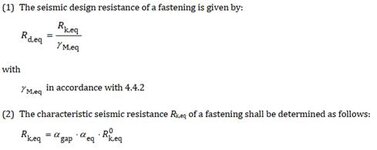

According to Annex C, part C.5 of EC 1992-4:2018, seismic design fastening resistance is given by:
where every anchor resistance is reduced with coefficients α that are ≤ 1.

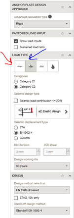

Do I input these forces as a permanent/ quasi-permanent load or as a seismic load in Profis Anchor HILTI software (red or blue arrow):
If the blue option (seismic design) is selected, software will reduce the bearing capacity of anchors according to Annex C formulas.
I am confused by the fact that if we have adopted a low-ductility structure with low behavior factor, do we deal with this seismic anchor calculation that ensures the ductility of the nodes in the seismic combination? Maybe I miss the point and I don't understand Eurocode very well, that's why I'm asking here.
