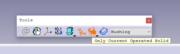

I like to rmb on spec tree and define in work object with the "Only current operated solid" option turned on in the "tools" toolbar.
