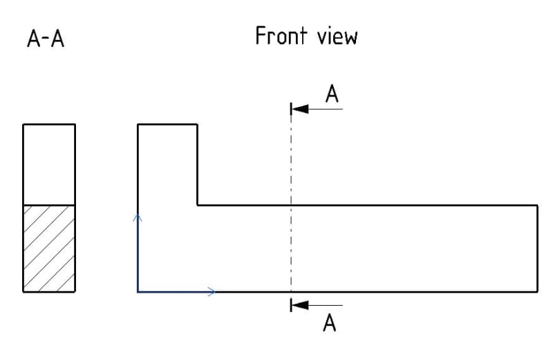

Need help from someone who is expert or using CAT VBA in CATIA V5.
I would like to control section view position on the drawing but simply don't know how.
When I record the macro it gives "Pure sketch"
So to explain, I have "Front view" and section view "A-A" generated from "Front view" and I want to move section on some other position.

I don't want to reposition view on the paper/screen, I want to change position of section A-A inside Front view:
Thanks in advance.

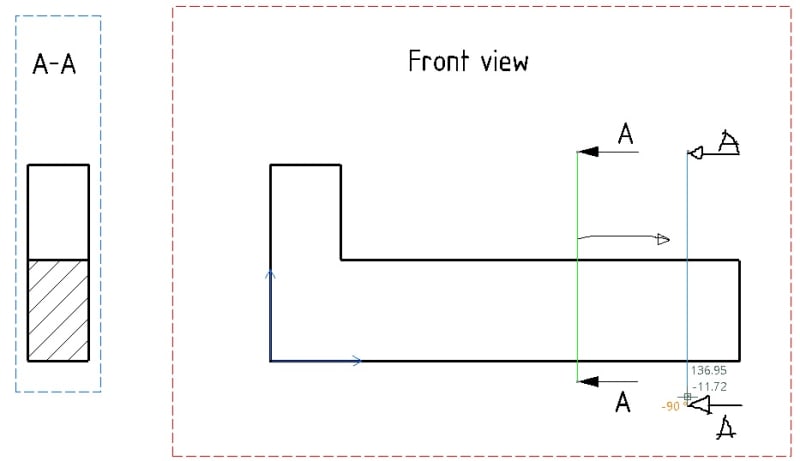

Have you tried changing arguments in GenerativeBehavior.DefineSectionView?
Hi Little,
in 1st code I've listed it seams that part of code which shall replace position of section is missing...I don't know where and how to find that part.
in 2nd code I've recorded macro where I'm creating new section A-A and then instead of creating new view I've tried to use already generated section view A-A:
'Dim drawingView2 As DrawingView
'Set drawingView2 = drawingViews1.Add("AutomaticNaming") '- this code I replaced with next one
Set drawingView2 = drawingViews1.Item("A-A")
Also I've replaced array for position of section but does not work.
So don't know what is the problem, why it work when the tool create new section view but not when I try to use already existing section view A-A?
Best regards and thanks for help.
I did record the section cut generation, and then I replaced the values from the arrayOfVariantOfDouble1(3)--and it worked.
the values are calculated with respect to the view's origin (the blue H- and V- axis)
Dim arrayOfVariantOfDouble1(3)
arrayOfVariantOfDouble1(0) = -380
arrayOfVariantOfDouble1(1) = 60
arrayOfVariantOfDouble1(2) = -380
arrayOfVariantOfDouble1(3) = -60
Set drawingViewGenerativeBehavior2Variant = drawingViewGenerativeBehavior2
drawingViewGenerativeBehavior2Variant.DefineSectionView arrayOfVariantOfDouble1, "SectionView", "Offset", 1, drawingViewGenerativeBehavior1
regards,
LWolf
Hi LWolf,
It works when you exchange array values and you create the new section view.
But what I want is to redefine existing section view A-A, not create new.
So the section profile A-A to remove on other position.
Thanks,
Zoran
