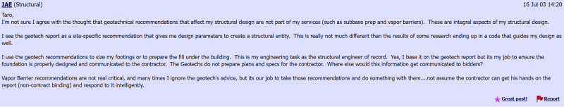

@Aesur I think the big thing is that construction documents (to use a more precise term) should show the final product and any required means and methods to get there (m&m not shown become contractor's m&m). The geotech report is more of a basis of design document that the structural engineer relies upon much like we rely upon the IBC/ASCE7/ACI etc. ICC reports and manufacturer's instructions have specific sections with installation instructions which the drawings can require the contractor to conform to - I think that notes telling the contractor to comply with those are more of CYA notes, and the contractor should obviously be following the manufacturer's instructions for the products that they use whether or not the engineer points it out to them.
chris - then why don't we show architectural and MEP on our drawings? (this is hyperbole, by the way) They are split out for a reason - each specialist shows what's required for his/her specialty. The same goes for geotechs. If they say that to get to the necessary allowable bearing pressure you have to excavate 6 feet, backfill with a certain type of material, compact it to a certain density, etc., then that's what the contractor has to do. There's no sense in duplicating the language, especially since I'm not a geotechnical engineer.
It is worth pointing out, of course, that geotechnical reports are not really meant to be static, and the ones we usually use for design are preliminary. Once our design is done and we have actual loads on the foundation and actual sizes and configurations, the geotech needs a chance to confirm any assumptions, adjust their calcs as needed, and remove any superfluous language (maybe they gave options for pile foundations OR spread footings on a job).

Listing the geotechnical report in the drawings or in the specifications does not make it part of the contract documents, it only makes it a referenced document.
A Geotechnical report is written for the engineer and not for the contractor, although the contractor will benefit from reading it. Geotechnical reports are not written in contract-style language and format, and thus are not suitable for inclusion into a set of construction contract documents. Geotechnical reports provide opinions and recommendations, but do not provide enforceable requirements like contract documents do. Consequently, telling the contractor to do work according to the geotechnical report creates unnecessary ambiguities. The engineer's job is to create contract requirements based on the geotechnical report, not to punt that responsibility back to the geotechnical report. A construction law attorney can provide a better and deeper explanation of this topic than I can.
If you want the geotechnical engineer to provide documents for inclusion into the contract documents, then have the geotechnical engineer write the Earthwork specification and any other related specifications that the project requires, along with preparing any related details for the engineer to put into the drawings. Some (many?) geotechnical engineers offer this service.
This kind of blanket statement is categorically false and misleading. It would depend on the language attached to it. What needs to be understood is NO language will be without legal "contest" in the event of a dispute.
It didn't count, it wasn't a requirement, it didn't say "shall", etc. etc. etc. ad nauseum. The geotechnical report is referenced in the Contract Drawings. Done. The intent is established that this is a contract requirement. Done. It's on the Contract Drawings. Let the lawyers spend 5,000 hours arguing it. NORMAL construction will take into account the compaction and subgrade preparation in the report, because it is referenced in the Contract Drawings, regardless of whether their hypothetical in-house attorney says it's non-binding. Ignoring it violates the standard of care, isn't workmanlike construction practices, etc. etc. etc.
