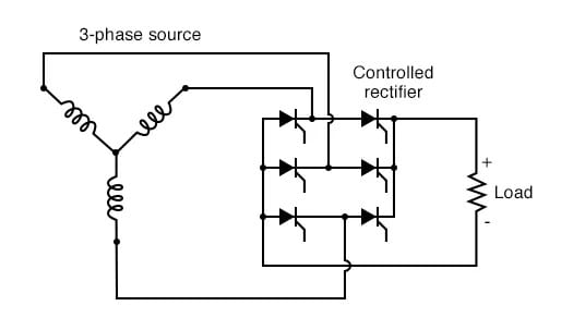

Is this a inverse parallel pair of SCRs per phase which then feed the rectifier, or are the SCR's the rectifier?

Typical SCR bridge.
Your scope trace appears to have transients at switch-on, and transients at the switch-on points of the other phases.
Check for overlapping trigger timing.
