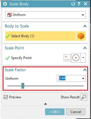

Does anybody know if it is possible to change the range of the slider scale on SCALE BODY for a specific part ?
The Scale Factor currently slides from .02 to 2.2 and I would like it to go from .4 to 1.0
Jerry J.
UGV5-NX1899
I don't know of any way to limit the slider values on a standard dialog. Failing that, you might look into adding a requirement on the resulting scale expression. NX should flag you when the expression value is out of the desired range.
