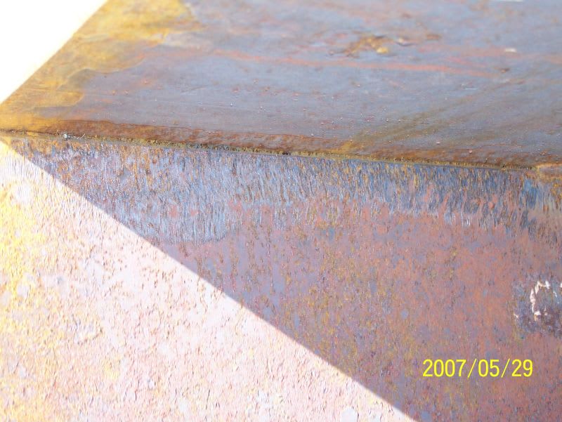

I see the word "mirror" used a couple of times above. Carbon steel plates, like SA516-70, never have a mirror finish. Below is a typical pic from our work.
Be careful about asking the customer. If the plate meets SA-20 then there's nothing to ask. But if you ask they will think you believe the plate doesn't meet SA-20 and assume they should reject it.
