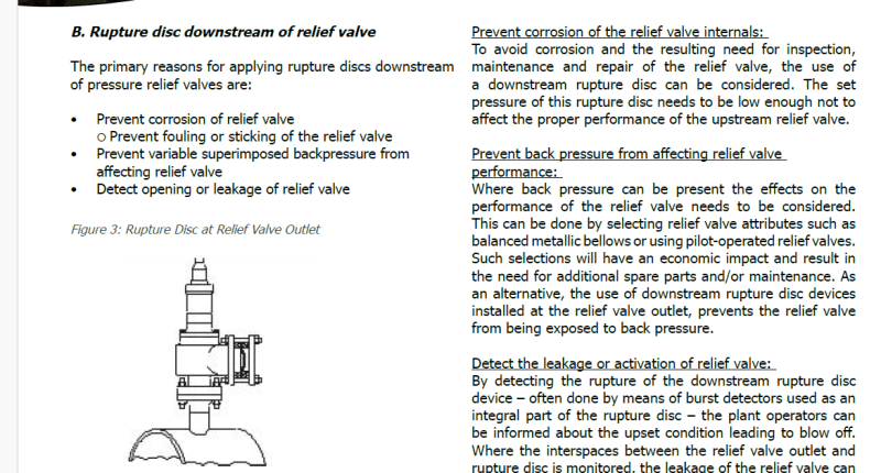

It seems clear to everyone that the current design, implemented many decades ago, is bad. We're exploring potential solutions, such as rerouting the outlets of these three problematic PSVs outside the system boundary directly. This would require collaboration with an engineering company that specializes in relief header routing.
However, I'm also curious about other possible solutions. Regarding code compliance, the three PSVs in question are balanced bellows types. The operating pressure of the vessel they relieve into(vessel C) is 30 PSIG. For PSV1 and PSV2, the setpoint is 95 PSIG, so the back pressure is not more than 50% of the set pressure.
I recently came across a document that mentions the possibility of installing rupture disks downstream of a PSV in certain situations. I'm sharing this because the rupture disk could prevent corrosive materials in the relieving header from backing up against PSV1, PSV2, and PSV4, thereby protecting the bellows from damage.
While PSV3 seems to be functioning properly, the issue primarily affects the PSVs that are backing up against vessel C. Our working theory, confirmed by metallurgical analysis, is that the material in the pipe is causing corrosion in these PSVs. In theory, a rupture disk downstream of the PSV could protect the internals of PSV1, PSV2, and PSV4 from damage.
I’d like to brainstorm with others who have more expertise in this area to explore these ideas further.

Rupture disc downstream of PSV will most likely not help - PSVs' all leak a little in real life, so RD will blow and you'll be back where you started.
So are you saying that the fluid in the downstream vent piping is more corrosive than the fluid upstream of the relief valves as the header takes other PSV discharge from more corrosive fluids than the systems that these PSV's relieve from. If so then I can see why you would have a rupture disc on the outlet similar to why you have one on the inlet if the inlet was a corrosive fluid. However, is putting one common rupture disc better than installing one on each discharge? I think it would be better with one on each discharge since it is 3 times more likely that 3 PSV would blow at any given time than one so you would be changing a common rupture disc 3x as often.
As far as limiting the back pressure I don't think so. Once the PSV pops it will see the same superimposed and same built up backpressure, even more since the rupture disc will produce more built up back pressure.
As for checking whether relief valve is leaking - maybe but a leaking valve could also be due to simmering where the upstream pressure gets close to relief pressure but the seats may still be OK. The pressure is likely to build up to a point where rupture disc ruptures before the PSV is properly inspected to know the cause of leaking.

2.4.4 Devices in Combination (Series)
Relief device combinations are normally used to take advantage of or combine specific characteristics that are not found in individual devices. The following are the most commonly used combinations.
Rupture disk upstream of a pressure relief valve: This is by far the most common combination used in the process industries. The benefits include:
* Prevention of leakage through the relief valve
* Prevention of product buildup in the valve nozzle
* Isolation of valve components from corrosive processes
* In-place pop testing of the relief valve (the value of this practice is not universally accepted in industry and only a few rupture disk types are suitable for this activity)
Rupture disk downstream of a pressure relief valve: This is typically accomplished with a low pressure rupture disk. The primary benefit is to prevent corrosive vapors in common headers from entering the discharge side of the relief valve.
Rupture disks in series: These can be factory supplied double disk devices or individual devices installed in series. These are typically specified for one of two applications.
* Highly corrosive or otherwise aggressive environments that are prone to disk failure with the goal of having the second disk remain intact to provide time for a safe shutdown without a discharge event
* To isolate the process side disk from variable back pressure in a common header
Virtually all of these combinations have a common disadvantage in that most of these devices are affected by the pressure differential across them and therefore the space between them has to be monitored and/or vented appropriately to ensure safe operation. Additional guidance regarding the use of combination devices is found in Section 2.5.5.2.
