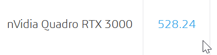

while modelling catia v5 only use 2 cores to 100% and gpu usage is around 7%.
frame rate in modelling is around 5-10 fps. Its stuttering a lot.
I know v5 is not multi core friendly and it is therefore why i see so low gpu usage because cpu cant feed gpu with enough data.
Is there anything that can be done. Anyone have and tips to improve this?
Upgrading to V6 is not oan option says my company.
if you have a Quadro then take the appropriate driver level
GForce gaming card are not supported. You have to try other nvidia driver until you find a better solution.
try to find something close to the 528.24 version approved by DS

I am using 528.24
you have a GForce or a Quadro ?
Eric N.
dell precision 7770 with rtx a3000 gpu
I would open an SR... contact your VAR or DS (if you work directly)
