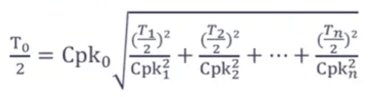

Also, I have a equation here which I find on the internet
T0 and Ti means (USL-LSL)
That's what I mean calculating the tolerance of goal dimension X with using diffierent Cpk on each parts
Is that right?

It looks like we were writing at the same time. I think the math would work out the same between your equation and the method that I described. I'll let you derive/check it. One important point, again, is that it's better to use Cp with the drawing nominal instead of Cpk, unless your process is 100% mean-centered. Cp is a measure of variation only, while Cpk considers the mean-centering, which should not go into a variation calculation theoretically.

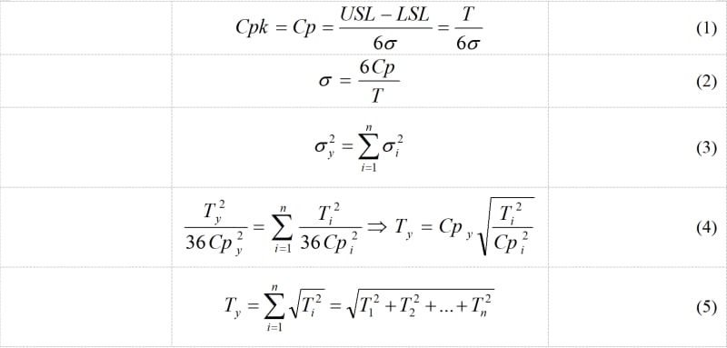

I'm trying to figure it out the meanings and calculating methods of each parameters that appears in Tolerance analysis (especially RSS, Root-Sum-Squares). For simplified, I make an assumation that "100% mean-centered",so I think it goes to be "Cp = Cpk" whcih leads to the equation (1) and (2).
According to the Normal Distribution, the standard deviation of target (name it sigma_y) and stack-ups (sigma_i) follow equ(3) .
Then, substitude equ(2) into equ(3), we get equ(4). For the situation like you said above, Cp=1, we get equ(5) which is the most common method to calculate "+/- tolerance values" in RSS tolerance analysis (most information I found on website follows this equation).
When trying to give diffierent values of Cp for stack-ups, equ(4) should be used to calculate tolerance values. For example Cp_1=1.33, Cp_2=1, Cp_3=1, Cp_4=1.33... . Obviously, after giving a specific value of Cp_y (such as, Cp_y=1.33), the target tolerance T_y is obtained. For sure, in the case where Cp_i and T_i remain unchanged, T_y goes changed by Cp_y. Bigger Cp_y leads to bigger T_y. I think this should be right[shriner].

Equation (1) is correct. Equation (2) has an algebraic error: the right side is inverted. Equations (3) and (5) are correct. Equation (4) needs to be reworked based on equation (2).

... also, in equation (5), the summing operator should be inside the square root operator.

OOPS, you're right. Thanks!
