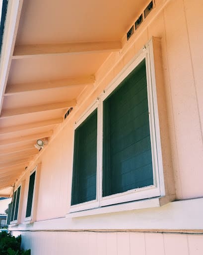

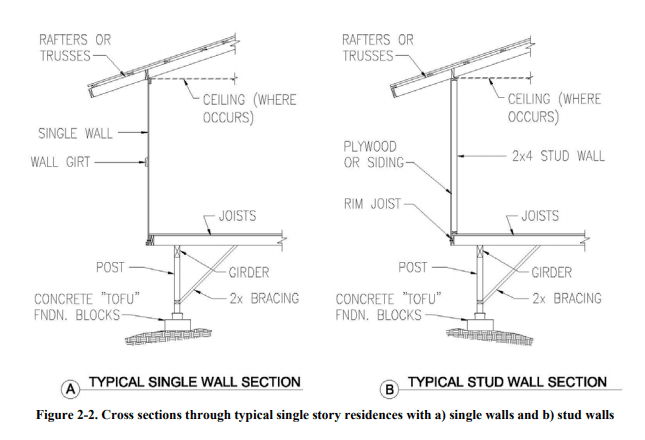

I'm afraid not. Not a post to be found. The type of construction is called single wall construction and the majority of these houses are built out of redwood. The technique fell out of favor sometime in the late 70's early 80's when it became mandatory to build stud walls. They are still super prevalent in the state though. Heck, my house is one. They're total pieces of crap but are easy to remodel due to their simplicity.
Here's what a typical one would look like....
3/4" T&G... wow... just another humbling moment of "I don't understand why that works"...

Talk about depending on a roof diaphragm to prevent wall spread (ceiling - where occurs). Wow. I guess the wall girt and it's connections are critical. Sort of acts like a tension ring to prevent wall buckling? I'm pretty ignorant of the weather in Hawaii. Are cyclones pretty rare? If so, I could see these working. I imagine they'd flop all over the place in an earthquake and spring back up when it's done.
Most of these homes were built before plywood was readily available so most roofs like mine are just also tongue and groove boards. The majority of these homes use either site built roof trusses or rafters and ridgebeam. I can't recall ever seeing one with a ridgeboard.

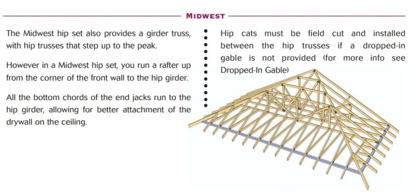

I think KootK is using what is called California Roof Framing.
Technically it's a Midwest hip set although the terminology seems to be in a state of perpetual drift. Gotta give the flat-landers their due: They came up with the version that seems to have become dominant.
