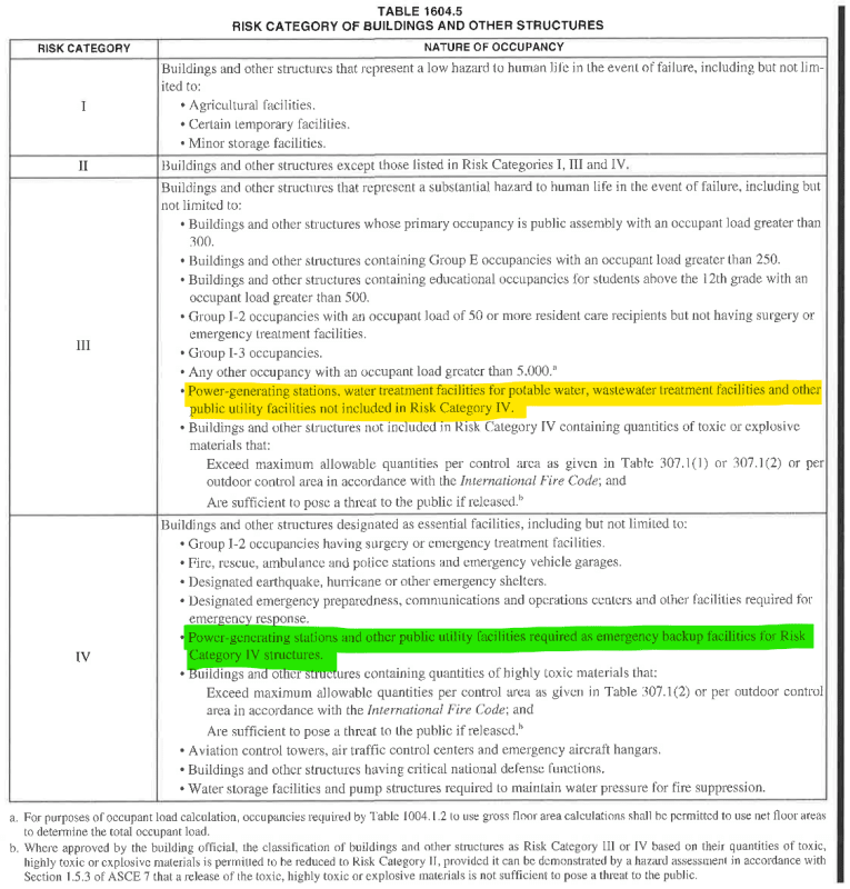

What risk category in ASCE 7 would be appropriate to use for Water & Waste Water Treatment Plants?
My initial thought is to use Risk Category III. However, I am wondering if Risk Category II would be appropriate instead.
Suggestions/comments are appreciated.

I will suggest you to look ICC Clause 1604.5 .
Acc.to TABLE 1604.5 , STP and WTPs are Category III. Copy and paste of relevant item ;
· Power-generating stations, water treatment facilities for potable water, waste water treatment facilities and other public
utility facilities not included in Occupancy Category IV.

Before you rush into anything, I'd be careful. We design water treatment and wastewater treatment plants typically to III (and by the way, that's pretty much all we do), unless we're in the hazardous chemical storage areas. If you need IV (or just assume it), you're adding a lot of $pecial in$pections and ob$ervation. You're not doing the owner any favors. If the facility provides pressure for firefighting, fine, it's IV. But making water is not the same as providing firefighting pressure. And by the way, wastewater is not considered a hazardous material, at least by code.

Based on this clause, it seems to me like Risk Category III is to be used.
This is what I initially thought.
