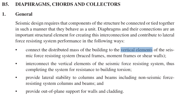

@sandman In Section 12.10.2.1, I'm interpreting "vertical elements" as shorthand for "vertical elements of the SFRS" (i.e., the braces not gravity columns). Doing a CTRL+F through Ch. 11 and 12, this is consistent with how the term "vertical elements" is used throughout the chapters and makes the most sense in the context of the section.

Vertical elements are members of the SFRS that exist in the vertical plane. Braces are considered vertical elements. From AISC 341:
