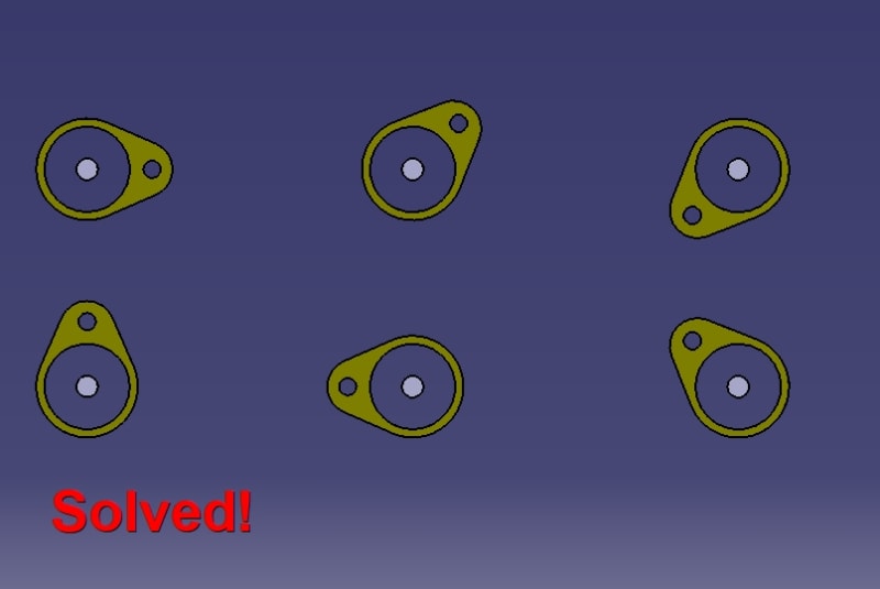

Is there any way to modify the orientation of selected instance in assembly which are created using he reuse pattern option in Catia V5?
Example: In the picture, center of the instance and Z height will be same for all instances but need flexibility in orientation angle.
Picture for reference and sample CAD assembly attached.
Thanks in advance!

A bit more thinking and issue resolved.... without Macro!!!
Revisiting Catia after a gap of 15 years... took a while to recollect....
Attached the solved assembly for reference just in case ....

@Vikey
So what is your solution, without a macro? The only way I can think of is to constrain each instance.
@jackk,
You have to only constrain the first instance with the first base feature (in this case Pad 1)
then use reuse pattern, check the assembly I have uploaded....
Thanks.
Thanks for sharing that Vikey. You can learn something new everyday!
