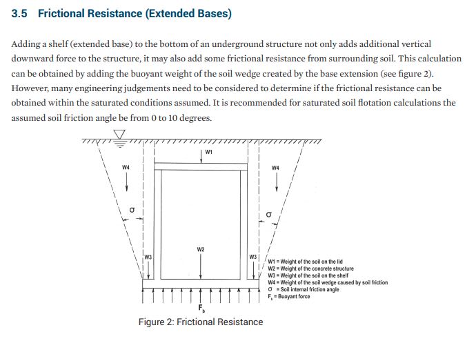

I have been taught to ignore the soil wedge of saturated soil and only use the soil directly over my footing extension in this exact situation. This is a mix of saturated soil is much weaker, this is also relying compacted fill interlocking rigidly after potentially only a few years, and it is just an increased factor of safety while not being all that unconservative.
WesternJeb, thanks for this, and what about the friction forces, did you consider it?
The soil would be acting as a gravity load (saturated weight minus the weight of water) on top of your footing. You will just have a rectangular section without forming the soil wedge.
If this is the case, I don't believe you will have a need to activate any friction force in the vertical direction, it is just soil bearing on top of your footing and applying a gravity load that would help resist overturning. Sliding (friction in the horizontal direction) isn't an issue since the base of your wall is integral with a concrete slab on the bottom of your tank.

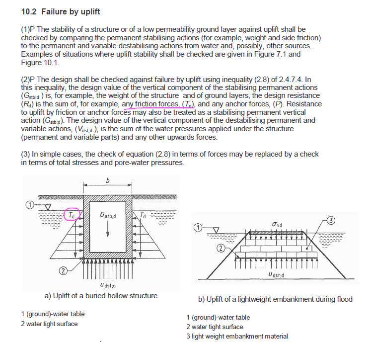

The question is what is the friction force between the tank wall and the soil, it is growing with the depth of the soil, lineary due to active pressure etc. See attached picture.
The snippet you have sent through is not the same situation as what you have. You have a footing extension.
Friction would resist the tank rising up if it didn't have a footing extension, but it wouldn't be anywhere near the full weight of the soil.
Think about how YOUR structure would fail with a footing extension. In order to come out of the ground, the soil on top of the footing extension would have to come with it. It would be gravity bearing, there wouldn't be any additional friction force between the soil and side of your wall providing extra capacity. I see your thought process, I am just letting you know what my senior engineers have taught me. It is a design simplification, and especially with everything being saturated.

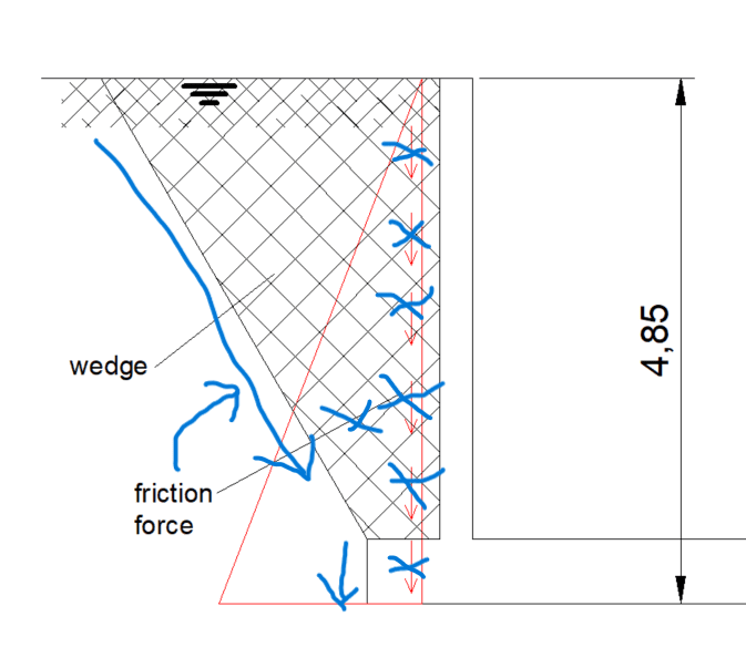

In that first drawing, you show a soil wedge and skin friction along the side of the wall, pointing directly down. If the whole thing (tank and soil wedge) comes out of the ground, the skin friction doesn't count (it cancels out, because it's an internal force between the concrete and the soil that are both moving upward as a mechanism...). If you want to be really aggressive, there could be some skin friction/sliding resistance along the angle of the soil wedge, but it doesn't point directly down, it's along the angle of the soil wedge, and I've not seen it done. I've seen skin friction used for piles, but I've not seen it used for WTP/WWTP. Then again, I have a limited history with tanks.

Seems you didn't read all the answers in the thread. So regarding skin friction/sliding resistance (uplift resistance of soil) it is something I already proposed and then PEinc sent a full design of uplift where American Concrete Pipe Association published an article which considers soil shear strength by using a vertical failure surface.

Oh I read it. You can't put a friction force between two things that are NOT MOVING relative to each other. Your soil friction arrow is in the wrong place. I haven't seen soil friction used in the buoyancy check on a tank. I've actually used the soil wedge to combat buoyancy.
Those pipe people may use a friction force for a vertical soil column, but the friction force is between the piece of soil that is moving (with the concrete) and the soil that is not moving. This is at least in line with practice of using skin friction (but no soil column) for an uplift caisson.

Friction doesn't occur only if the two solids/surfaces slide, it occurs also when two surfaces try to move (they are in balance due to the friction)
No. or rather, irrelevant. You can't put in an internal friction force that cancels out in the free body diagram, then add a second friction force at the interface. Or, you can put it in, but it won't be there in reality.
Customarily one does not use static friction in these situations. Static friction is higher than sliding friction, so you end up with an unsafe design. Again, I've not seen a buoyancy calculation for a tank that uses sliding friction along the soil boundary. If the soil is wet that friction force will be fairly low anyway, or zero if it's cohesionless (sand).
This link has a section on OP's question, with them recommending to exercise judgment when assuming friction, and to assume a wedge of 0-10 degrees.
It's an interesting question as to what sort of wedge, if any, can develop. When calculating forces on walls with saturated backfill we still use these standard earth pressure theories with large friction angles, and corresponding failure wedges, so what's really going on? Why are the basic earth pressure theories still ok to use underwater when the soil is mush and isn't as frictional any more, and isn't wedging like that anymore?

Yeah the angle (sigma in that drawing) depends on the soil properties, sand, being generally cohesionless, won't have a sigma. I also notice that there is no frictional force along the hypotenuse of the soil wedge.
Swimming pools are smaller, so it's perhaps less useful to add the wedge, when it comes to a full-on WTP/WWTP tank, it seemed common to me at the time. Not that I was sealing the design. I was the junior guy running the SAP/SAFE model, and doing the uplift (buoyancy) check. The other thing that might affect it is the old eminent domain areas where WTP/WWTP were placed were in terrible soils, putrid MSRs, etc. So using every plausible "kitchen sink" to make the buoyancy check work might be involved.

@lexpartie, there is no friction in sand? Just read the pipe people paper as you called it, it's based on American Standards etc.
