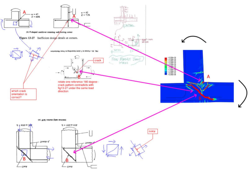

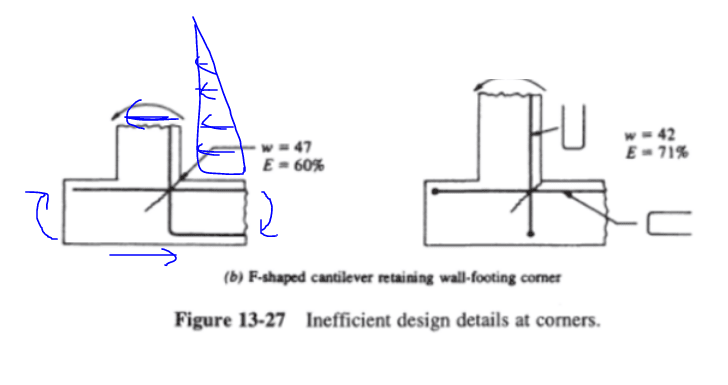

Navigating the various references in the post, I tried to understand the crack pattern at the intersection between the retaining wall and the footing. Using plane stress transformation from what I could remember from the mechanics of materials, I focused on a small square element within the moment transferring joint and tried to find the orientation of the diagonal tension. Most of the crack patterns I got conform to the corresponding references, except one. Additionally, one reference seems to contradict the other in terms of the crack pattern. Please see the pictures below.
I would appreciate any help.
Thanks,

That being said, I don't think the two are directly comparable. The location of the cracking being looked at is different (at the opening corner vs inside the bend radius) and the reinforcement configurations aren't the same (the direction and/or lack of a bend, the presence of the horizontal reinforcement)

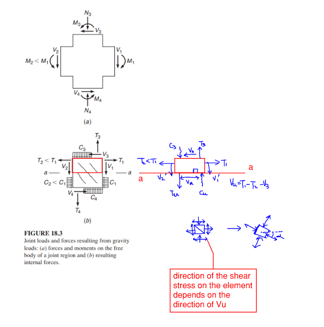

I studied this grenade for a bit per Nilson's Design of Concrete Structure 14th Ed Chapter 11. The book says a (moment transfer) joint will develop a pattern of diagonal cracking owning to the diagonal tensile stresses that result from the normal forces and shears.
Typically, a joint is not in pure bending — there might also be shear and normal forces, see the figure below. The direction of the internal shear at section cut a-a is unknown, as it depends on T1, T2, and V3. Looking at a small element at the boundary of the section cut a-a, the direction of the shear stress on the sides will determine the direction of the crack (diagonal up or down), and the magnitude of the shear & normal stress acting on it will determine the angle of the crack with an orthogonal axis.
Referring to the figure I had a problem with, I suspect the test engaged a shear force similar to what a typical retaining wall would experience. Maybe the graphic just didn't show the shear force. The direction of the internal shear within the joint decided that the crack pattern would be like that.
At the risk of venturing back into dangerous territory, I'd like to add my two cents. You have a crack at the inside of the joint attempting to tear open (call this Crack A). Additionally, there is a perpendicular crack through the middle of the joint caused by a busting force from the compression bottle strut (call this Crack B).
Since the forces are turning the corner, the principal tensile stresses are not uniform throughout the joint, making it not a matter of one crack being correct over the other. Both crack tendencies exist in different sections of the joint, and the diagrams you show are considering each crack separately, depending on which is the critical one in question. I have reoriented your diagrams so they are all matching and have also added an extract of a finite element model of a similar situation, illustrating the two different cracks.

Thanks. That makes more sense. As for your FEA model, did you apply pure moment?
For the sake of completeness, what does crack B look like in the model if the reinforcement bend points in the other direction?
Why yes, I do in fact have no idea what I'm talking about
That FE model was from a paper.
Here’s the experimental case where the legs turn back across crack B. Slightly better performance.
