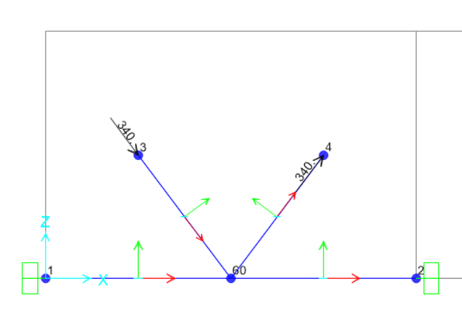

Apr 18, 2020 #1 mekafime Mechanical Joined Aug 14, 2015 Messages 88 Location PE Hi please, I need to restrict the movement in bar ... (I want it to move only in the direction of the red arrows) The force is applied on the diagonals (bar 3-60 and bar 4-60) Thanks.
Apr 18, 2020 #2 petb Marine/Ocean Joined Nov 1, 2005 Messages 120 Location FI Assign local axes for joint 3 and 4 and then allow axial movement only. Upvote 0 Downvote
Apr 18, 2020 Thread starter #3 mekafime Mechanical Joined Aug 14, 2015 Messages 88 Location PE How? Could u tell me the steps? Upvote 0 Downvote
Apr 18, 2020 Thread starter #4 mekafime Mechanical Joined Aug 14, 2015 Messages 88 Location PE I assined local axes and put forces , but I dont know how gives axial movement only Upvote 0 Downvote
