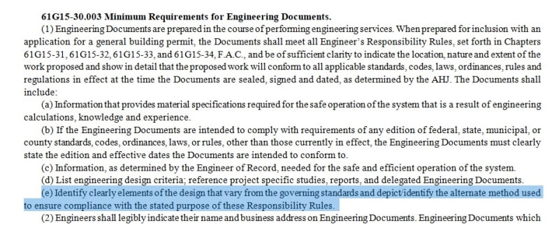

As a point of reference, Florida does have specific rules for this king of thing, where you deviate from the design standard and explain how and why, so you need to explicitly disclose such a deficiency.
"All deviations from Department criteria and standards must be uniquely
identified, located, and justified; no blanket approvals are given."
In the context of design engineering, I think it is best that these sort of plans where you obscure the engineering design criteria should be handled as "NOT FOR CONSTRUCTION" sets, but, having been involved in a fair number of projects that did get built off of "NOT FOR CONSTRUCTION/FOR PERMIT ONLY" drawings, well, this sort of thing is not actually within your control in the absolute sense. I don't endorse doing this.

This disciplinary ruling isn't all that on point, but it does reference FL 61G15-30.
ABBAS BORUJERDI, PE, PE No. 38553 – REPRIMAND, Case No. 2020010497
ROBERT T. HAUG, PE, PE No. 24575 – PROBATION, Case No. 2021021749 & 2020055905
