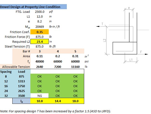

Hello, dowels can be used to address overturning moments due to eccentricity of the load. Below is a sample calculations I use for L shaped footings at masonry walls.

If you need to engage more of the slab for uplift resistance (code only gives you 6" prescriptively with WWF), then use hook bars into the footing.
