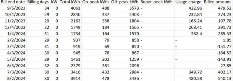

This is what I saw. Just totals by month:
-Jason, Architect
Arp32,
Not much to go on. I expect the zero in the kW column simply means this is not a demand customer. Take the kWh and divide by the number of hours since the last read, and you will have the average kW for that time period, with no information regarding the mins and maxes.

Some utilities provide more detail. I can go in the Duke Energy website, or use their mobile app, and download kWh readings in 30 minute intervals for my home energy meter. With this, you can calculate 30 minute demand values.

kW demand is the difference between consecutive 15 min kWh readings times 4.
If you have an average power use for 15 minutes of 1 kW, then the kWh usage for that period is 1 kW time 0.25 hr, or 0.25 kWh.
