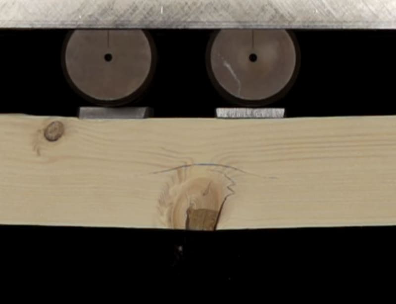

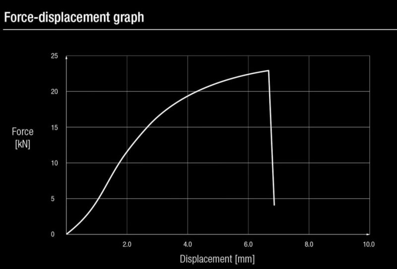

One data point for consideration: Link. 50 sec in if you're not down for watching paint dry on a Friday afternoon.
Look at this bad-ass yield plateau from the same test. We should start dong special moment frames in wood.
Although, given the nature of the situation, this one based on a defect is probably more representative: Link Failure appears to progress from initiation to completion at roughly the speed of sound.
The failures denoted in those tests have the appearance of a brittle fracture but the intensity of the brittleness does not appear as severe at is would for unreinforced concrete or masonry. I have been around wood members when they literally broke. You do get some warning and then they pretty much shatter. You hear something is going wrong right before they Rice Krispie on you.
What do you think is occurring at about 10 kN where the curvature changes on the graph? I have tried watching the video slow to see if that is where you can start seeing the bearing plates compressing the wood.
Vastly out of my depth on this but when has that stopped me:
- I think it's all about the tension fibers being... fibrous.
- Initially, you get stiffening as the fibers align themselves for maximum load resistance.
- At 10 kN, the fibers are done straightening and maybe start doing something like necking whereby your effective cross section, and thus stiffness, is reducing.
Kootk,
That seems to be a rational cause and effect. My first thought was the bearing but each time I watched it, the bearing depression appeared after about half the sag, not at the third point of the sag.
Yeah, based on the relative difference between available compression stress and tension stress, I doubt that minor damage on compression side would make that much of a difference.

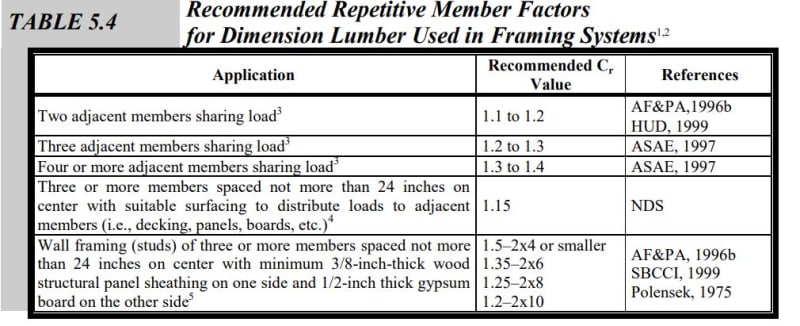

Rooting around online, I found this from a HUD design guide.
- Higher values have been proposed.
- Testing has been performed, particularly on built up headers.
- Some good references there for anyhow who might be feeling super keen. I'd be interested to know the nature of the testing.
