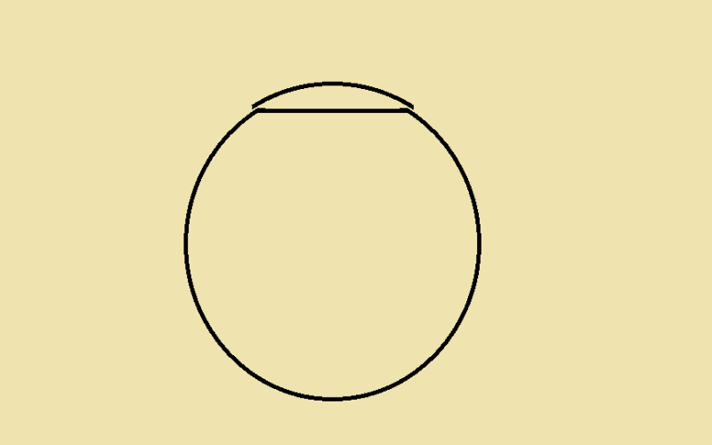

Internal pressure acting all around the inside of a cylinder tends to round it out.
If you have uniform pressure around most of the cylinder, and one part without any pressure, that part will tend to flatten in.
If you weld a repad, and there is a leak between the cylinder and the repad, but no leak between the repad and the exterior, the result is that section of cylinder has equal and opposite pressures acting inside and out, which sums to zero pressure in that area.
So, it should try to flatten that spot and transfer load from the cylinder to the repad, which the repad is not designed for.
IE, a leak in the wall in that case could make a difference in the stress distribution, rather than just being a leak.
