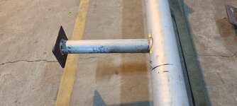

@GD2 Not welding the pipe to supports but welding steel to piping for structural support like dummy legs. Either pipe or in some cases even a beam. I attached a picture of the type of supports I am asking about.

As others have noted, Caesar won't check the local stresses that you need to consider for a support attachment - this is true for dummy legs, lugs, saddles, whatever. That's just not within the capacity of a Caesar beam element model.
The Paulin suite of tools is really something every stress engineer should have alongside Caesar or whatever general pipe stress program they work with. Nozzle Pro and FE-Bend making checking local stresses a relatively easy process. The Kellogg method is ok for a very quick first check, but it is so grossly conservative that I find it hardly worth bothering with anymore. There are plenty of connections that fail Kellogg that easily pass under FEA.

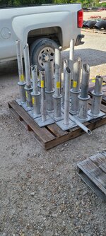

As for the general principle of welding a dummy on 10S pipe, again, I've done it routinely and found that it's not the boogeyman we were lead to believe. It's not going to collapse like a beer can, and the lack of corrosion allowance to worry about means that the wall thickness doesn't carry the penalty that carbon steel does.
I generally recommend upsizing the pipe diameter of the dummy leg before considering a repad on the elbow.
As for the idea that welded attachments shouldn't be used for pipe supports - that's just not the way things work in B31.3 world with our clients. Welded dummy legs and base supports are the industry standard like the attached pictures. These are typically shop welded by the pipe fabricator and shipped ready to assemble.20230808_093217.jpg20230808_093859.jpg
