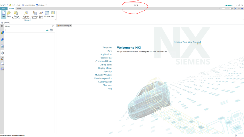

I want remove NX version that is shown in the top middle of the nx application window
How can I do this?

Here is the screenshot

I can comfort you with that the version after NX 12 does no longer have that number there.
Which , I think is BIG mistake, but that's a different story.
No, I do not think you can remove that.

I don't recommend removing the version number, but you can do it. It requires editing some of the menu files in the NX install. Offhand, I don't remember which ones. If you search "menuscript window title", or something similar, you might get some hits.

Create a file like NX_title.men and save it on a startup folder.
put this code in the file:
VERSION 120
EDIT UG_GATEWAY_MAIN_MENUBAR
TITLE NXcustom
