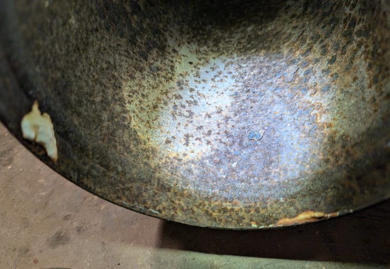

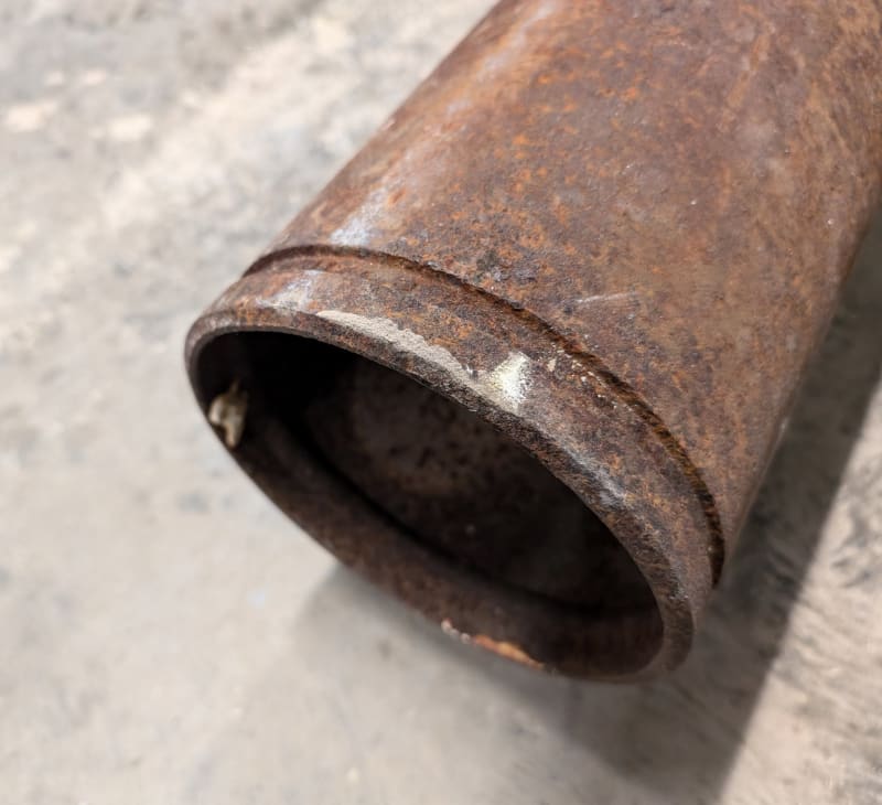

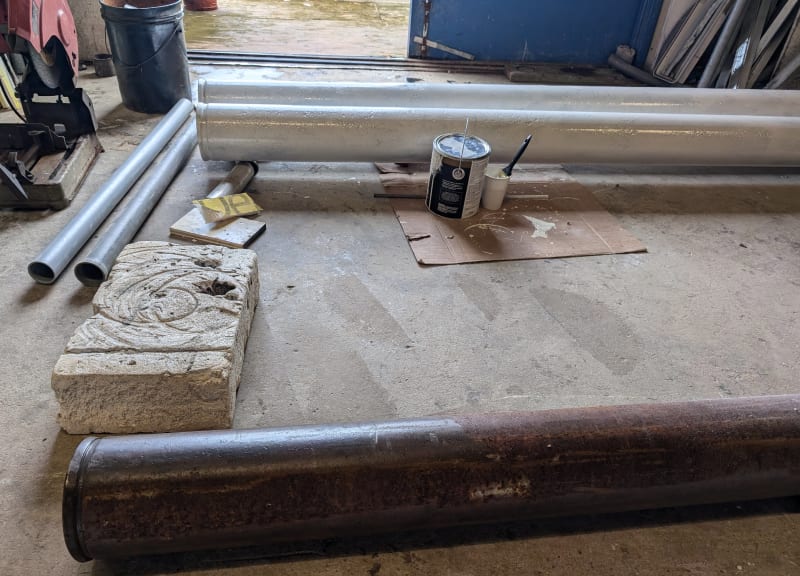

I'm assisting a US based facility on an island, and a Contractor has had a half dozen nominal 20' sticks of S40 A53B 6" grooved piping sitting outside in his storage yard. For years. It is to be used in a chilled water distribution system (40F at about 70' head). The exterior of the piping is, as would be expected, rough. Rust craters maybe 1/16"+ deep. Wire brushed and painted it looks...like old rusty piping that has been wire brushed and painted...[surprise]

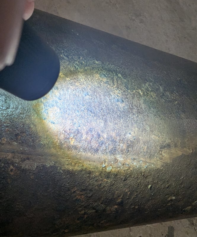

The interior is not much better - best comparison would be an inconsistent 30-40 grit sandpaper - with some areas at 20 grit and fewer at 60.
In my honest opinion, this material is now suitable for fenceposts or the scrap dealer...
See pics below.
I have advised the owner to reject this piping, and make the Contractor purchase new. As would be expected, the Contractor is pushing back. "It's not too bad, it will clean up nice, etc."
As can be seen by the pics above, the outside (after wire brushing and painting)is ...fair, with some wall thickness loss. But the inside is still cr@p. I know of no way to de-rust the inside of half a dozen sticks of 20' steel piping. If they were to build a giant bathtub and use a chemical rust remover, I would think that might work; but with another reduction in wall thickness.
Is there anything I am missing? The owners are kind-of trying to find a middle ground. This seems like such a no-brainer decision to me - "No." That said, it is really hard to get materials here. Think a once-a-month ship, and whatever you want on the ship needs to be at the dock 2 weeks in advance. It makes construction projects really drag out, and they are under pressure from politicos above to get this project completed. My final recommendation to the owner's staff has been "you do not want to accept compromised material for a system that will be in service for literally decades."

Wire brushing is the worst thing possible when it comes to good adhesion for paint, but then you also need proper primer and decent paint, not what looks like stuff you would paint your house with.
Any chance of a decent grit blaster available? Sometimes places like car repair shops have them or you could fly one in with an internal spray nozzle? And some bags of proper grit, not sand of the beach.
I've seen worse but it needs to be taken back to proper bare metal, not "polished" with a wire brush which just removes all the required roughness for the paint to stick on.
And get some two pack epoxy and some primer on the plane while you're bringing in the grit blasting machine. Compressed air you should have available?

I am more than a little concerned about the degradation of the cut groove that the gasket fits in. This is/was literally the weak point in the piping - even before this rust issue. Thoughts on this in particular?

The grooves should be OK, just make sure they use new elastomers not ones which have been sitting there as long as the pipe has...

You want something like this for the inside, but search pipe internal grit blasting for alternatives
Build a trough and fill it with phosphoric acid. Immerse the pipes in the acid. Most of the rust will dissolve. The rest will convert to a black compound called iron phosphate which adheres well and can be painted over. This process also etches the metal which provides better paint adhesion.

The real problem is the amount of Cl down in the pits.
Acid cleaning would be best.
Then decide if the pipe even still meets the specification.

Painting over the corrosion in your pictures is not different than painting over mill scale. Your process is simply missing a step.
If you want the pipe rejected, then tell them to clean it back to white metal (grit blast and/or pickle) and then you will inspect it.

Thanks gents for the knowledgeable comments. I have advised the Owners Rep I am dealing with that while there are a few ways to remediate this, all involving considerable time and expense, and the result will still not be equal to new pipe. You paid for new pipe; not refurbished pipe that may - or may not - have the same longevity as new pipe.

As concerning as the external (visible) general rust and untreated corrosion is,
- and the near-certain probability that "several specific points" with the internal corrosion on the salt-water "puddles" deep in the bottom and the sagging middle of the three or more of these pipes have locally deep, very penetrating corrosion points,
- and the widely spread general dirt and corrosion products internally that will foul and plug up heat exchangers and the "equipment" that this chilled water system will serve,
is the pitting and rough surfaces of each of the "sealing areas" inside and across the surfaces of the notches/ring-contact surfaces in the sealing areas for each rubber washer.
All,
It was indeed the pic of the o-ring sealing surface that finally convinced the Manager to say...NO.
