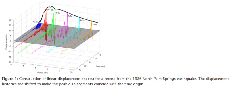

The text for the figure says MDOF (Multiple Degrees of Freedom)system and associated mode shapes; I fail to see the relation between mode shapes and degrees of freedom, is it so that a degree of freedom = a mode shape? So in the figure below we will have "n" amount of degrees of freedom and mode shapes?
When looking at the response spectrum, I understand we want the peak values of the blue, red, purple etc curve seen in the figure below, and they each represent the response of a SDOF system, so they would each be the response to an excitation of the blue wiggly lines in the first picture?
Edit: Is it so that the longer the period T (s) the more important the mode is for the overall response of the structure?
To be clear, the first picture is showing multiple mode shapes of a cantilever column that is MULTI degree of freedom. In reality, response spectrum would approximate the behavior of your structure using a SINGLE degree of freedom system with a frequency similar to the Mode 2, Mode 3, Mode 4.... frequencies. So, it always be "mode 1" of the single degree of freedom system. Just a system with a different stiffness or mass such that it's frequency changed. I tend to think of this as a series of cantilevers of different lengths (and hence difference frequencies).
And, yes, the longer period is usually the one that dominates the behavior of the structure... but not always.

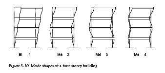

Which text ? will you provide some snaps ? I think the first picture does not represent the mode shapes of MDOF system.
I preferred copy and paste some figures from some books related on this subject.
The above picture depicts mode shapes for 4 storey bldg from Seismic Design of Buildings to Eurocode 8 ( Y. Elghazouli )

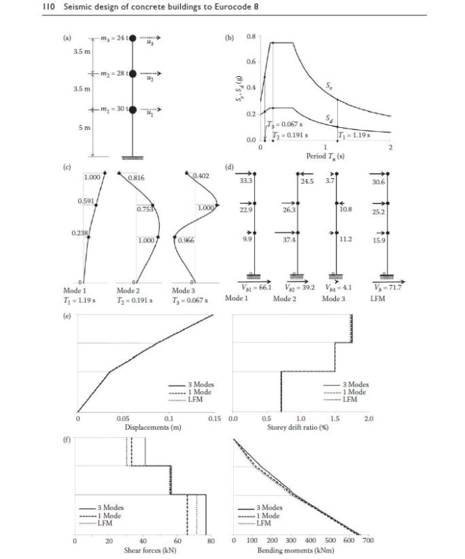

And this snap from the book Seismic Design of Concrete Buildings to Eurocode 8 depicts a) three degrees of freedom model; (b) elastic and design acceleration spectra; (c) natural modes and periods; (d) storey forces and base shears in the three modes and for lateral force method, LFM (kN); (e), (f) displacements, storey drift ratios, shear forces (kN), bending
moments (kNm) from modal analysis with one or three modes and from the lateral force method.
