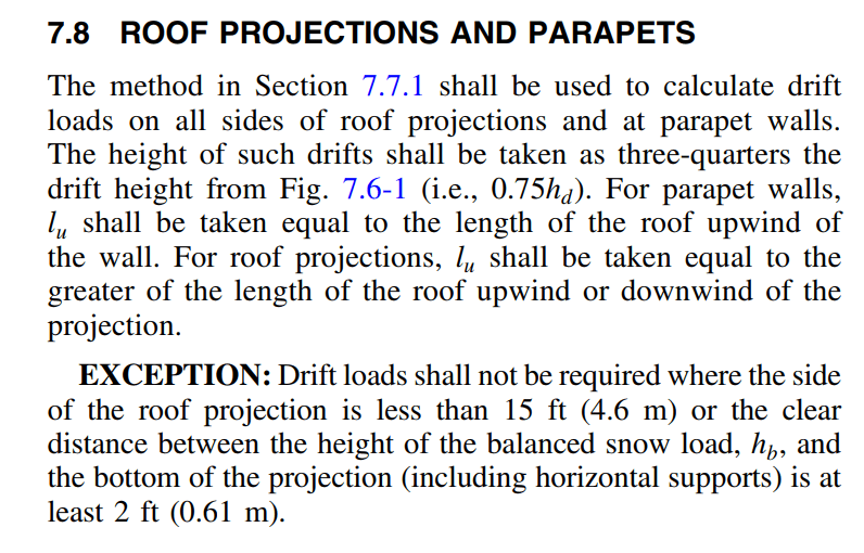

If this is in the US, snowdrift can be neglected for roof equipment with plan dimensions less than 15 ft.
The trusses current span 22' on top side of page and 29' on bottom of page. I just ran a snow calc and with roof height difference of 2.75', length of upper roof = 7.2' (length of unit), and length of bottom roof = 19' (length of roof to back edge of roof), I get a drift width of 5.36' with snow drift of 23 psf. This will obviously increase the shear and flexure. In this case I think sheathing on both sides of truss would be a better reinforcing solution, depending on loading obviously. This is in the US.
mfstructural, you can ignore snow drift.
Your RTU is less than 15 ft wide.
With smaller RTUs like this we haven't really taken it into account. I have another project with 10'x30' RTUs....for those drift will need to be considered obviously. So I will go with reinforcing with 2x12 of Top chord.

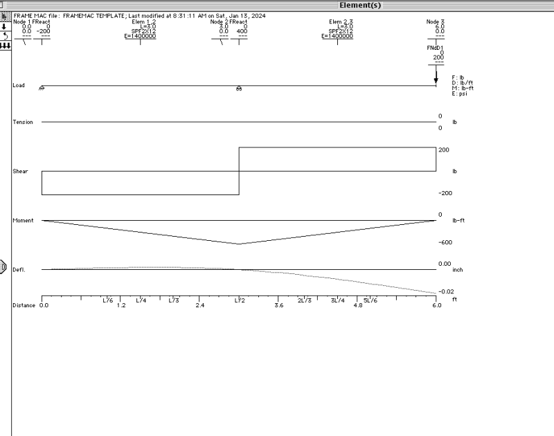

You could look at the 2x12 fix this way. Just attach it to one truss and let it cantilever. I modeled the 2x12 here with a 200 lb imbalance (i.e., the part under the compressor) This is just a guess. The cut sheet for the unit is need to figure out the actual CG.
Anyhow, the 2x12 only deflects 0.02" and has plenty of capacity. The 200lb uplift is resisted at the panel point of the attached truss - which should not be a big deal for a truss of this scale. I would attach it to both trusses and not worry about anything snapping. Use an LVL if this is a concern as they are pretty impossible to break.
