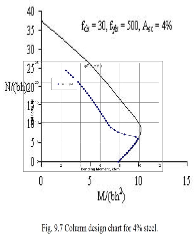

I tried to create an excel sheet to create new reinforcement charts for rectangular and circular concrete columns for Eurocode2.
I referred the calculation in the book "Reinforced concrete design to eurocodes by prab bhatt"- Page 355, section 9.2.5.1
But after I get all the calculations in the spreadsheet, it doesn't look like the line in the following chart
Is there any other books/videos etc which shows step by step calculations to produce charts? So, I can cross check and rectify my spreadsheet?

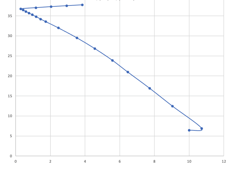

No, it looks like this and I can't figure out why. I have many points though, did multiple calculations through excel.
@milkshakelake
That's what this post is about, I'm trying to find some book etc which contains correct steps.

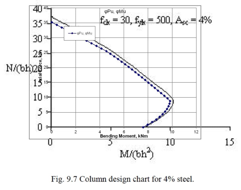

This is what I get using my RC Design Functions spreadsheet, based on a rectangular section with equal reinforcement in the top and bottom face:
The blue curve shows my results. The difference from the book graph may be due to my including the additional reduction factor in the UK National Annex, and/or different assumptions about the cross section or distribution of steel.
From your graph it looks like you are not taking moments about the composite section centroid, since you are getting an increasing bending moment as the stresses approach uniform stress across the section. If you can post your spreadsheet I'd be happy to have a look at it.

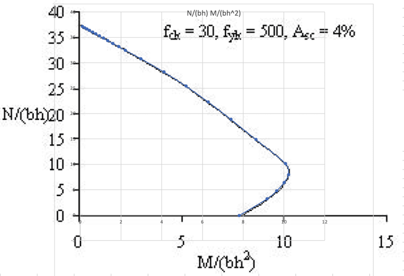

Thanks everyone, finally got it perfectly aligned with the chart
