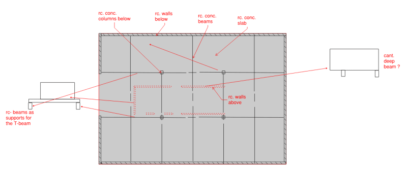

Hi folks,
Has anyone of you designed a reinf. conc wall which is terminating on the slab that is above a parking space so the walls are not terminating at the foundation.
I would design the wall as a deep beam if I had any support points for the wall but unfortunately I do not have any beams or columns on either side of the wall so that is why I am exploring different options which makes sense both theoretically and practically.
I would be curious if I could consider it as a reverse T- shape beam slab being the flange and wall the web..
Do you guys have any refernce on the matter or any experience on a similar or same situation in the past ?
You still don't have any support for the web, so how is the "reverse T-shape" helping you?
here is my thinking process :
The deep beams with cantilever at the right should be okay. They do not rely on the slab for support.
The walls at the left are not straddling two beams, so they rely on the shear and bending capacity of the slab (which would need to be checked to see if it is adequate).
In neither case does the "reverse T-shape" have anything to do with the problem.
Is this for works being done to an existing structure? otherwise i assume you would simply move the beams or make it a flat plate transfer slab?
The building is not in a seismic zone and it is not an existing structure.
In this case what is hindering ? just shift the beam axis and provide at least two supports.

Unfortunately moving the beams is not an option otherwise I’d have done that ..

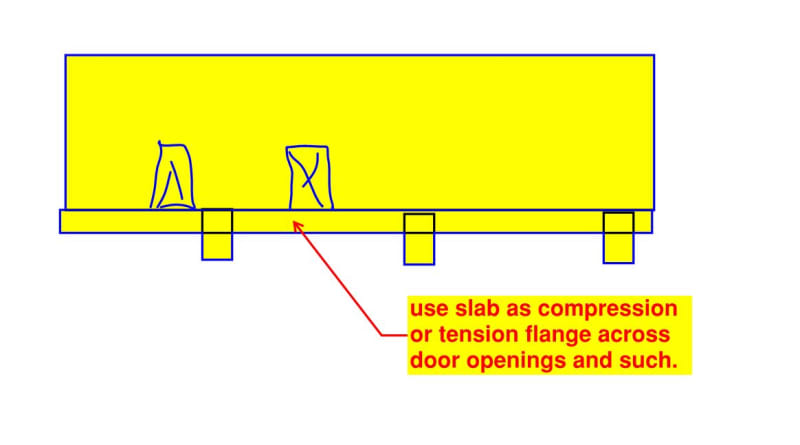

I could probably get behind that, using the slab to bridge the door openings for deep beam flange forces etc.
You'll want to either shore the slab below the walls or consider how the wet weight of concrete in the walls will tax the slab.
You will, of course, need enough wall meat above the doors to resolve beam shear there.
Be realistic about where the walls will likely deliver point loads to hard spots in the supporting slab.
