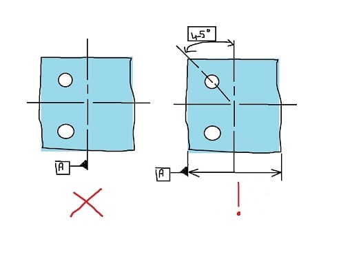

Hi All,
So referencing centre lines or part axis as Datum Features is not legal, no problem, I understand why.
However, I see drawings that reference such centre lines or axis for linear and angular dimensions all the time (at least where I work). Can someone explain the difference?
See attached.
To my mind these are equally ambiguous.
 https://files.engineering.com/getfile.aspx?folder=e5ac5e61-83d6-4568-a3de-e9db1d3d967e&file=Axis_reference.jpg
Assuming that GD&T is being imposed there, the difference is that those dimensions (linear or angular) are taken from the datum. By definition, the datum is the theoretically exact center plane or axis (if we're talking about a feature of size). And by definition, the datum center plane/axis is derived from the datum feature, which is precisely what the triangle symbol is identifying.

What I show is legal, but it sucks. Datums[ ]A and[ ]B are attached to features of size I did not bother to dimension, although that would be mandatory on a serious drawing. The centre-lines and the centre of the part are defined by the datum features. A radius dimension from the centre is horrible drafting. Almost certainly, there is a better way.

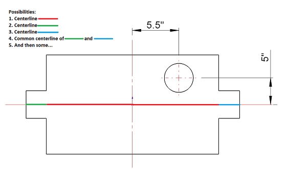

There is nothing wrong about dimensioning from center lines.
Only if you decide to use GD&T symbology, it is your responsibility to correctly specify, where the centerline is derived (see picture):
R1chJC,
Your drawing is a perfect example of why we should use GD&T positional tolerances. I can see four ways to define the horizontal centre-line, and four ways to define the vertical one. Maybe we know where the hole is, and the dimensions are showing us where the centre-lines are! Datums specify what features control those centre-lines. This drawing is uninspectable.
