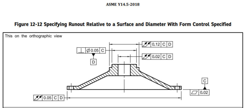

Fig 9-7 / ASME Y14.5-2009
If total runout defining datum feature D is replaced by position callout would you consider that the newly created position to be self-referencing (and hence not valid)?
Reasoning: I am thinking that position is checking the UAME and since D is secondary in the FCF than RAME is the one coming to play.
(Disclaimer: I am not saying that I would apply such callout, but I am just questioning its legality and validity, not its functionality)

Hi, I am working exclusively with ISO, but have seen examples from ASME Y14.5 in other threads on Calypso forum where they point to figures in Y14.5 that is a similar case where a datum is self-referencing. To me, its self referencing and not something that would be supported in ISO atleast. I am more familiar with the updated case that @SeasonLee showed from Y14.5-2018.
In the proposed case the feature references a theoretical construct that isn't congruent with the feature. It's the use of the theoretical construct that severs the self reference.
This may not be what happens in ISO, but it is a primary concept in ASME Y14.5 references.
In ISO too, the datums that define a datum system are oriented relative to each other per their theoretical exact relationship. A secondary datum axis line would be exactly perpendicular to the primary datum plane. This would not be the case for the element being evaluated for position. So in the OP case, an ISO-compliant evaluation would not yield a measured value of zero, either.
In fact, because under ISO the evaluated element is an imperfect line and not the straight axis of ASME, the measured result is expected to indicate greater variation than per ASME.
I see now, that primary datum was C, not D my mistake. @Burunduk, I agree. Still, I am yet to see an example as such in ISO GPS standards.
The associated feature for the cylinder would be min circumscribed per ISO default rule and the situation feature being a straight line - axis of the associated feature. I assume that is different from Y14.5?

No, what you described would be the same in ASME, under different names. The "true geometric counterpart" of D would be the min circumscribed with a constraint of perfect perpendicularity to C, and the datum would be the straight line-axis of the "true geometric counterpart".
The difference would be in the element that has to fall into the position tolerance zone. Per ASME it would be the axis of the "unrelated actual mating envelope" - which is the straight line derived from an unconstrained min circumscribed cylinder of that feature.
