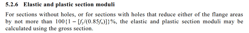

Under the code I use (AS4100) and there is reasonable chance that your code is similar, bolt holes (unless they reduce the flange area quite significantly) don't reduce capacity. The AS code below allows for the local area around the holes to under go some yielding and relies on ultimate tensile strength of the small are of flange around holes.

**Depends on your approach to the connection design. A quick check of the design guide that I use assumes all the moment resistance is found within the flange. Whereas at full member capacity some moment resistance is actually performed by the web. Thus using THAT specific connection design you are never going to reach full member capacity due to an conservative assumption that differs from the assumptions made in calculating member capacity.
How are you commuting the strength? Seems like flexural rupture per F13 applies. Rupture might not apply especially if the channels are A36.
