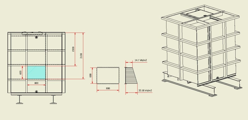

Hi
what formula would you use to calculate the deflection and stress on the portion of the tank's wall showing in the screenshot below?
Let assume the tank is full with water, open top and ignore the atmospheric pressure. Material S275 6mm thick

Why fixed edges ? ... because the edges of the panels are supported by stiffeners. But assuming simply supported edges will probably give a higher (more conservative) result.
If I was doing this (and didn't want to use FE on it), I'd analyze a stiffener (reacting 1/2 a bay of panel on both sides) since the stiffener is the key structural element (reacting the bending from the pressure).
If I had to analyze the panels, I might analyze a strip (1" wide, horizontal and vertical) to see how the panel reacts as a plate in bending. Normally this shows that the deflections are large (compared to the thickness) and so the panel reacts pressure as a membrane (with in-plane forces).

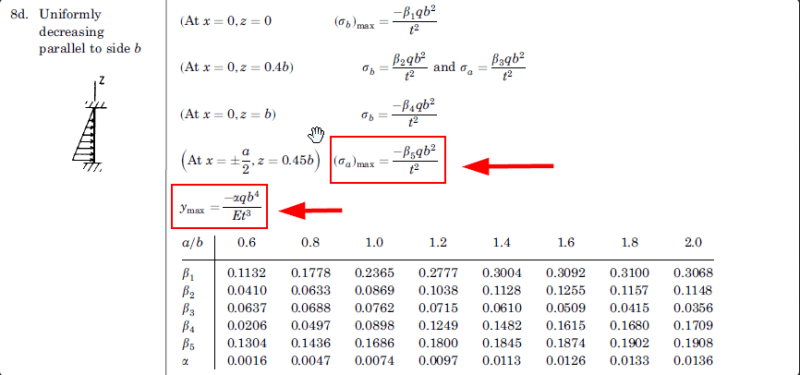

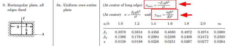

I did look. I think the formulas in the screenshot below (case 8d) is the best option. I think I should apply it for the triangular part of the pressure 5.88kN/m2, and the previous formula (second screenshot case 8a) for the continuous pressure 14.7kN/m2. Tell me if I'm wrong.

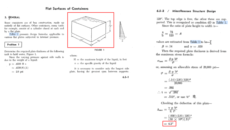

I have got many of these books, looked at the examples, tested the first one (not stiffened tank) in FEA and the deflection result was very different [ponder]

ok, yes ... you can superimpose these two, but remember they are the maximums for each loading, and may not be coincident but is a conservative approach.
Also similar for simply supported edges (so you can see the difference the boundary condition makes.
You should try to find Roark's reference (a Corps of Engineers report by Moody) ... no, the reference for these is Timoshenko. There you'll find the general expression for stress for these two loads (not just the maximum).

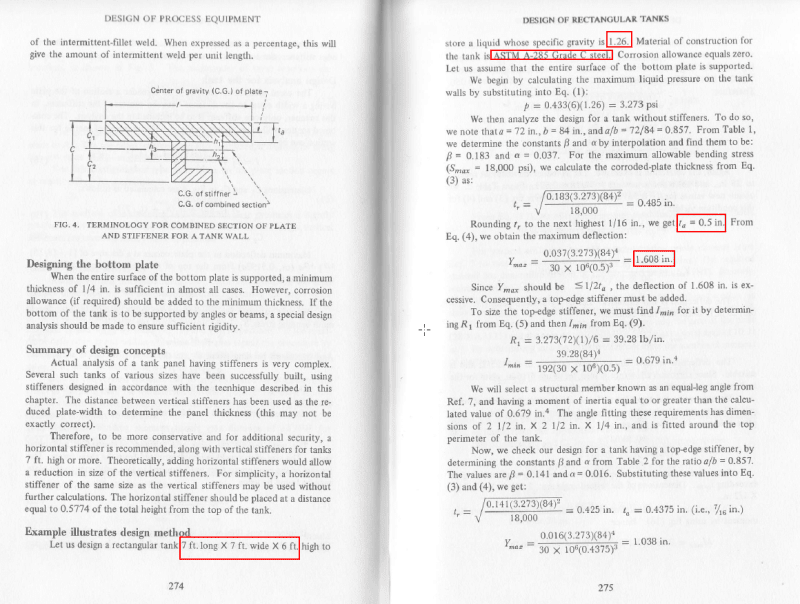

I tried to replicate in Nastran the example in the book of Kanti Mahajan(see screenshot). The deflection in the book is around 40mm - in Nastran 7.5mm

Another example from another book (Design_of_Welded_Structures_Omer_W_Blodgett). The deflection in the book is around 110mm - in Nastran 25mm
