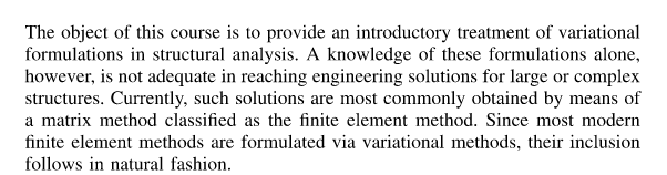

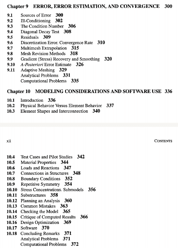

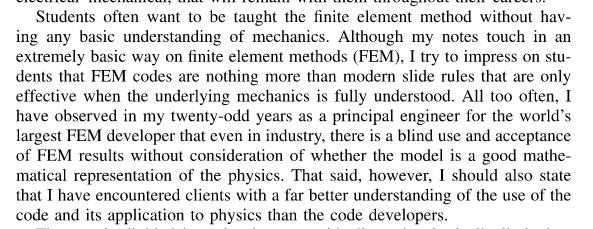

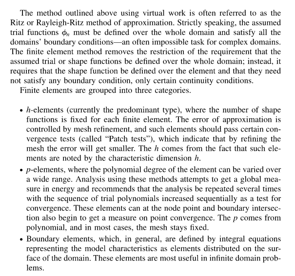

For a deep dive like this, I've found nothing remotely as good as the Wallerstein book shown below.
I know, this seems like a weird recommendation given that it doesn't have FEM in the title and only mentions it in one of the chapter subsection titles. This is how it should be. All that is FEM really amounts to little more than an application footnote the the grander picture of variational methods. I assure you that a PDF search for "finite elements" and "shape function" in the book turns up a ton of hits, as you would hope.
I've included some clips of the Wallerstein book below so that anyone is interested in it may get a flavor for it.
The Wallerstein book only gets as far into FEM as axially load member systems. However, it dives deeply enough into the development of that version of FEM that it's easy for a reader to imagine the extension of the method to more complicated systems. It's a brilliant presentation in my opinion.

The Cook & Malkus book is an excellent reference for avoiding the pitfalls of spurious modelling. As shown below, there are two entire chapters that are pretty much focused on that topic and, in my opinion, they are the chief strength of the book.
I don't feel that it is practical for all FEM users to be deep dive experts in the theory as Wallerstein wishes. I think that we'll wind up being a world of semi-black box FEM software operators who, at best, are well trained in avoiding mistakes even if their understanding of the underlying theory is limited. One goes to ware with the army they have, not the army they wish they had.
