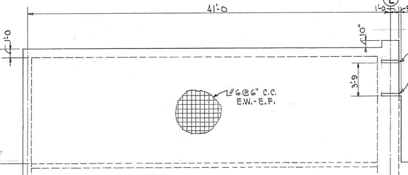

Here is some background of the situation. We have an existing concrete ceiling with several #6 rebar loops cast in place that we are looking to hang some piping from(2000lbs). I have the geometry of these loops and have determined that they can carry the load just fine from a mechanical standpoint, but my concern is the load on the ceiling. This is an area that I have not dealt with before. Are there any resources that I could be pointed to to determine what kind of forces it would take to pull these loops out, or is the main concern going to be the load on the slab itself? I know it will depend on the composition of the slab, so I have included the details that I have on hand from the drawings used during construction.
Slab Dimensions: 36' x 40' ceiling 12"thk. there are no intermediate beams or columns in the room, just floor walls and ceiling.
Reinforcement: #6 rebar 6" center to center both ways, top and bottom

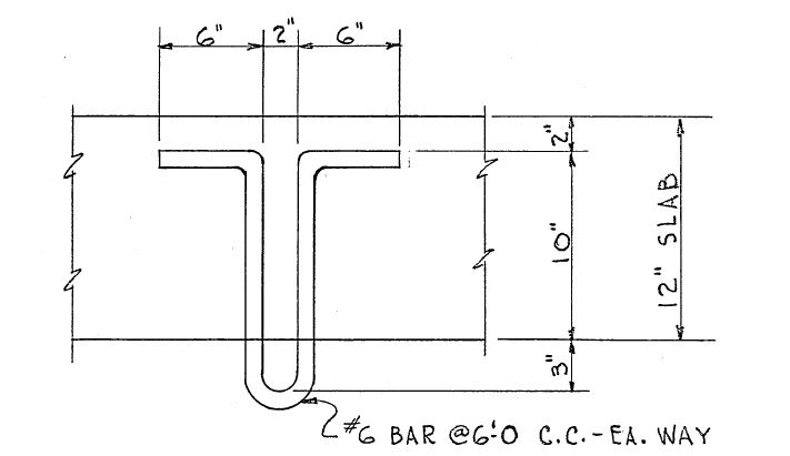

Jed, I have attached a few screen clips for a visual description. A better way to describe the loops might be stirrups that protrude and have a "u" loop as the protrusion.
STIRRUP DETAIL

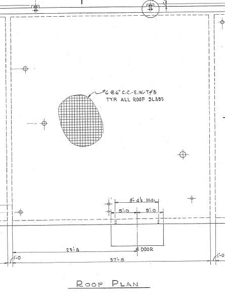

HTURKAK, I have added a few screen grabs of the original prints that show the some of the dimensions of the slab. My initial though was to load test them, but we want some form of calc to back up the load test. You are correct in assuming the weight will be across multiple loops, 4 or 6.
SIDE VIEW
TOP VIEW
Was the original purpose of these to be hanger attachment points? If so, I imagine the design load would be stated on the original drawings somewhere if you have them.
The difference between a stiff rebar embed loop and a flexible prestressing strand does have some worrisome characteristics, but they're used quite commonly in lifting (precast concrete, deadmen for construction). I wouldn't be concerned for a 2000 lbf load on a #6 loop.
The global analysis of the roof for the additional load will require more information (environmental cases, what's above and around). Easiest if you can send that to your local structural engineer. Although depending on the applicable building code, you may get away under the "less than X% change" provision.
The issue I think is most likely to control this installation is the anchorage of the embed loop into the roof. One could pretty quickly calculate the capacity of a pair of L-bolts embedded into 10" of concrete (or just one for simplicity). You'll have a little more capacity because of the slab reinforcing, but that's harder to quantify.
