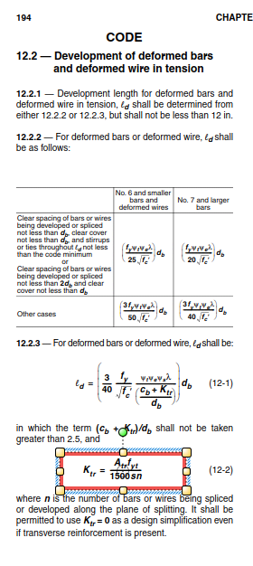

We know transverse reinforcement is required to be provided at the lap zone of rc beam, I would like to know your practice if shear links are already provided for the beam, the area of transverse reinforcement in additional to the shear links area or not

I'm sorry but [again] this is incorrect. Read the ACI development clause again, the 12-1 development equation considers this effect. Honestly, I don't know how to say it again and again and get through?
So let's approach it from your side, you prove why you're saying ACI318 does not consider this when the K_tr factor [as I've noted twice previously now] considers A_tr [the transverse steel total area and spacing and number of bars crossing a split all form part of eqn 12-2],
In ACI318-08 clause 12.2.1 states you can use eqn 12-1 for L_d which then uses eqn 12-2 for calculating K_tr.
So why are you stating ACI318 does not consider this effect? I'm at a loss to understand your logic, it's in black and white in ACI318.
Just because you say it repeatedly does not make your view any more correct.
ACI318 commentary definition - Ktr is a factor that represents the contribution of confining reinforcement across potential splitting planes.
in 12.2.2 the (cd+krt)/db is assumed to be 1.5 hence why 12.2.2 doesn't mention Ktr or Atr.

Here's another vote for it contributing in ACI through the development length facto Ktr.

Very glad to have participated in this discussion, and finally reached the root of my knowledge lapse after a big circle. This is not an excuse, but since the change in code for calculating development length (in the 90s?), I've conveniently and conservatively taken KTR = 0, thus the reason for it has been neglected until now.
