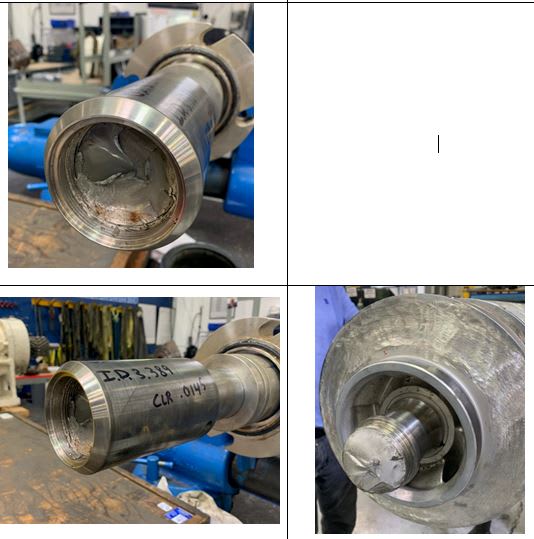

Hello,
We received a pump because it failed prematurely due to shaft breakage. After disassembly, we found that shaft was broken at throttle sleeve corner. Pump was last repaired about a year ago and shaft was not replaced. Can you tell what can be the failure reason? The pump ran for some years before this happened.

Can you attach the pictures as files so that we can zoom in on them. The images in the post are scaled back.

Agree with above posts. The break seems in itself to perhaps be initiated by material fault or surface damage.

Pump had no vibration issue before shaft failure.
Pump was running within 15% of BEP flow during operation.
Pump has a sister spare pump on side that runs alternatively with this one. So they are switched to make sure they are both operationally good.
Pump stopped in 2-3 seconds after failure.
Shaft did not show any other crack during in liquid penetrant test.
A 9-stage pump has quite a long casing and will be very sensitive to misalignment due to pipe strain or soft foot. This won't necessarily cause vibration. The recent service would make me suspicious as that opens the possibility for an incorrect alignment.
What was the condition of the bearings, wear rings, and balance disk/drum?

I don't know much about pump shaft sleeves and probably don't have much to contribute. But I'd like to ask how is the sleeve affixed to the shaft... is it interference fit, or is it threaded (I think I see some threads there).

This shaft was broken at threaded areas of throttle sleeve. Wear ring running clearances are not too high (0.017"-0.020")
Here are detailed pump operating conditions:
suction pressure : 30 psig
discharge pressure 1500 psig
temperature 190 F
shaft rpm 3560
fluid produced water

That info, doesn't really add anything. You need to establish the mode of failure, from there you can start looking into what operating condition resulted in the failure.

Is it possible that a shock load created by water hammer from a discharge line check valve suddenly slammed shut during a second pump switch. These pumps create very high pressure and volumes at 3560 rpm. The internal rotor clearances are usually very small to produce high hydraulic pump efficiencies and normally won't tolerate any misalignment between rotor and casing. All rotors are balanced for their specific rpm. Any deviation of the rotor would normally show as rub marks at impeller wear rings against case rings. Or in the area of center stage piece.
I am certainly not an expert on shaft fatigue and the photos supplied are not that inclusive, but what I see is a gradual operational failure (fretting and staining) with a final overload failure (clean fracture).

A question if I may, the shaft failed in the threaded region of the sleeve you say, so are the shaft and sleeve screwed together at this point? If so I would be looking at the threaded areas on the shaft because the base of the thread could be the high stress point for a crack to initiate.
