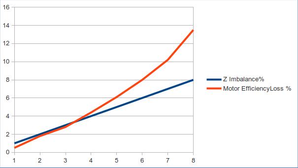

I was interested in impedance unbalance calculation as there is a relation between impedance unbalance and loss in motor efficiency (exact relation I am looking for; some graphs are available online -
I have also seen that online analyzers report this value. Now my doubt is - if we are measuring three phase voltage (using voltage dividers) and three phase currents (using CTs installed at three conductors) at motor control center, how to calculate impedance ? Since in delta connected motors, conductor current divides into two of the windings. I have similar doubt for power factor calculation too. Can we calculate true power of motor using above mentioned measurements ?

I'm not impressed with the blogger you quoted.
In particular this one: Why is Impedance Imbalance for Electric Motors so important.

I am kind of speechless. He defines the impedance he's talking about... it depends resistance and inductive impedance. And it also depends on a capacitive impedance? But more importantly, there is no slip!?!
The only picture I can cobble together to explain such gibberish is that the author views an electric motor as a network of impedances that may be unbalanced. And apparently it is connected to a balanced voltage source, and the resulting currents vary in inverse proportion to the impedeances (I = V/Z). This neglects the effect of slip in determining the effective impedance while operating. It neglects the fact that motor current unbalances more often originate from supply voltage unbalances (rather than from motor impedance unbalances). It neglects the fact that the high slip associated with the negative sequence circuit means that the negative sequence impedance is far lower than the positive sequence impedance.
I see there is similar line of reasoning in another presentation associated with All-Test Pro here. It is equally gibbberish.
I feel bad picking on these guys who are not here to defend themselves. It is what it is. My advice to you is ignore these resources and look for more reliable resources.

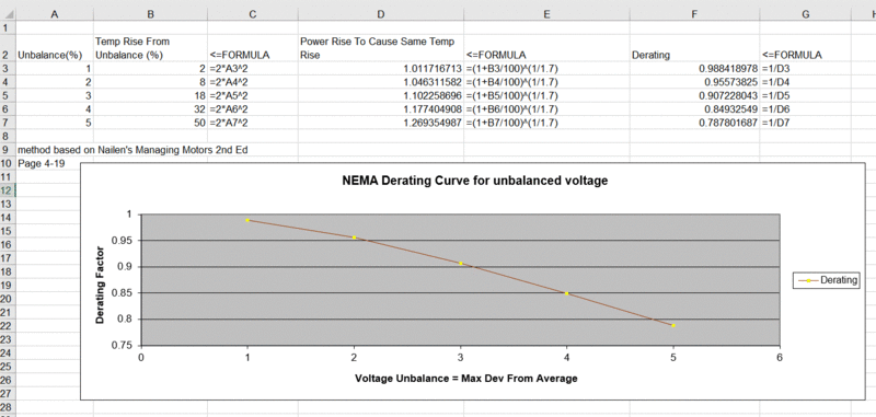

If you have an appetite to understand the basis for the Figure 1 derating curve from the first link, the screenshot below is a spreadsheet I created awhile back to help me understand the logic built into that graph. It references something from a Nailen publication, I'll add that part later.
If you have an appetite to understand why figure 2 of that first link looks the way it does, there is a relatively straightforward (albeit theoretical) explanation given at a second link here. Basically it is just applying the induction motor steady state equivalent circuit to both the positive and negative sequence circuits, with different slips (Figure 1 of that 2nd link)

I'll add one more thing. When you read the literature you see that maximum deviation from average (as a fraction of average) is treated as a proxy for negative sequence (as a fraction of positive sequence). It falls from the assumption that there is no zero sequence present (which applies the set of three phase-to-phase voltages whose vectors form a closed loop starting where they ending, and also applies to current flowing into any power system load that doesn't have a ground in it). With these assumptions, a numerical check confirms V-/V+ is almost exactly equal to the (Vmax-Vmin)/Vavg.
