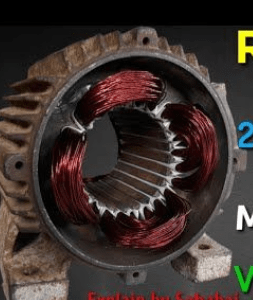

I need to re-coil a electric motor because of burning trough.
Sended the pump to a electrical mechanic to do the job.
Got back the pump and during the testing got a result of approx. max. 30% of it's original pressure and aprox. 1600 RPM"s.
He admitted that he didn't counted the original windings during demolision.
He copied a sort of similar electric motor.
After a few ugly words he refused to do the job again and got back the payment.

My findings:
Motor is 1-fase
Should be coiled 2 poles
Stator has 24 slots
With coil 1,575"
Intern stator radius 1"
Accoording a formulas found on the net the amount of windings should be 365.
Got a result of 3450 RPM's (matches approx. the tag plate)
And all that thanks to the internet.

Now has the stator 8 slots filled with a thinner wire (the starting coil) located at clockwise 3 o'clock and 9 o' clock.
The other 16 slots is winded with appro. 240 in total (variing from 29 to 31 windings per bundle)

A 3400 RPM motor running at 1600 RPM?
It sounds as if it was rewound as a four pole motor instead of a two pole motor.
It should be rewound with a two pole configuration.
Then the starting winding placed at 90 degrees to the main winding.
Try this;
Two pole winding.
or this:
Two pole winding.
If your winding looks like this, without the starting winding, it is a four pole motor and will run at 1/2 the speed of a similar two pole motor.
