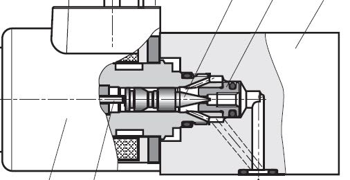

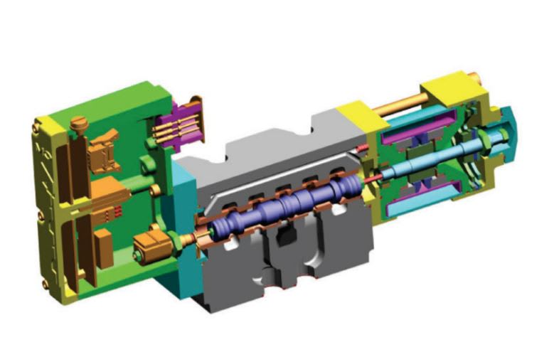

Anna, depending on where you are in the world, the word "servo" is sometimes used to describe basic pilot control as well as proper servo valves used for control systems. That can cause some confusion.
Yes I am aware of that, it is a bit of a language barrier sometimes. :)
This is what I call a proportional valve, command value 0 to 10 V or 4 to 20 mA quite simpel (no fuss) ;-)
And this is the one we have that is called a servo proportional valve and it has a motor and it is a bit more to this one.
None of them comes with more the command value contra flow or pressure curves or with flow contra pressure drop curves.
I am not saying this to be critical in anyway it's just a fact for these two valves.
