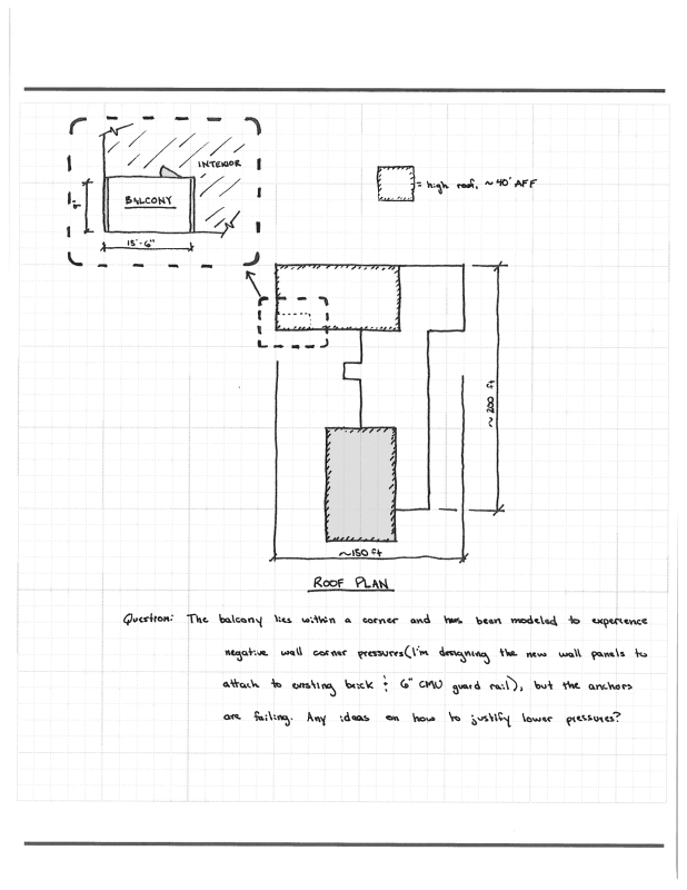

Question about the wind suction pressures for an enclosed balcony.
AnimusVox
Jun 17, 2015
45
Refer to the attached diagram.
I'm trying to justify using a lower pressure than the negative wall corner pressure so that I can make these anchors work. The balcony is enclosed on three sides by existing brick, and the exposed side has a 6" CMU guardrail. The balcony also has a roof over it.
Let me know if you have any questions, and thanks in advance.
