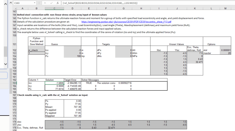

The Scipy library has several solver functions that will do what you want.
Examples can be found in my xlScipy3 spreadsheet, which can be downloaded from:
The spreadsheet calls the Python functions from Excel using xlwings, but if you prefer to work directly with Python the Python code is included in the download.
For solvers with more than one unknown see the Solvers2 sheet, which use the Scipy.Optimize minimize function. You need to write a function that returns the difference between calculated and target values for given inputs, with output as a Numpy array, and the minimize function will adjust the inputs to minimize the differences.

To use Scipy you will also need Numpy, but they are both pretty well indispensable for engineering work with Python.
As an example of what you can do with Numpy, using the xloc list from your code:
Python:
import numpy as np
# Convert xloc to a Numpy array
xloc = np.array(xloc)
ICX = -1.69
# Subtract ICX from all xloc values in one operation
xIC = xloc - ICX
Doug Jenkins

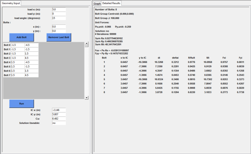

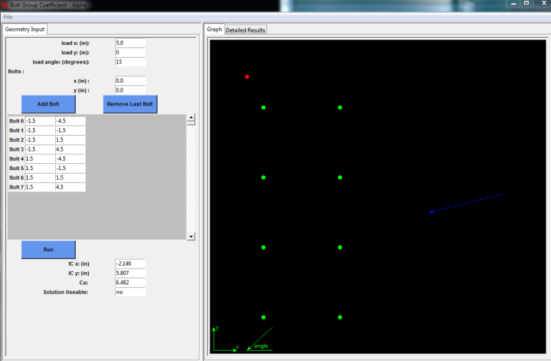

hmm learned something new hadn't ever looked into Scipy for this, here's my code below which seems to check out:
It is pretty sensitive to where the initial IC coordinates are assumed to be
As IDS notes you can condense a lot of this down to single line steps using numpy arrays, I kept the bulk of it as native python lists and broken up into the calculation steps.

Open Source Structural Applications:
I improved the results slightly by also back checking sum Fx and sum Fy in my optimization function:
It is still very sensitive to the initial IC coordinate guess.
There is a great article on AISC for this by G. Donald Brandt from 2nd quarter 1982:
Python:
def ic_optimize(IC,xloc,yloc,ecc,theta):
    res1, res2, check = ic_check(IC,xloc,yloc,ecc,theta)
    res = res2[0] - res2[1]
    px = res2[0]*m.sin(m.radians(theta))
    py = res2[0]*m.cos(m.radians(theta))
    fx = px + res1[0]
    fy = py - res1[1]
    res_magnitude = m.sqrt(res*res+fx*fx+fy*fy)
    return res_magnitude

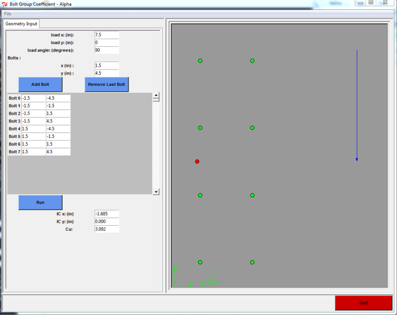

Brandt's Method is much more reliable:

def brandt(xloc, yloc, P_xloc, P_yloc, P_angle):
    # Bolt Group Instantaneous Center using method by G. Donald Brandt
    # Rapid Determiniation of Ultimate Strength Of Eccentrically Loaded Bolt Groups
    # AISC Journal 1982 2nd Quarter
    detailed_output = []
    num_bolts = len(xloc)
    n = num_bolts
    detailed_output.append(num_bolts)
    #Bolt Group Centroid
    if len(xloc)<3:
        anchor_x_bar = (xloc[0]+xloc[1])/2.00
        anchor_y_bar = (yloc[0]+yloc[1])/2.00
    else:
        j=0
        x_tot=0
        y_tot=0
        for i in xloc:
            x_tot = x_tot+xloc[j]
            y_tot = y_tot+yloc[j]
            j+=1
        anchor_x_bar = x_tot/len(xloc)
        anchor_y_bar = y_tot/len(yloc)
    cg_anchors = [anchor_x_bar, anchor_y_bar]
    detailed_output.append(cg_anchors)
    # J - Polar Moment of Inertial of Bolt Group
    # sum(x^2+y^2)
    sum_x_square = 0
    sum_y_square = 0
    i=0
    for i in range(num_bolts):
        sum_x_square = sum_x_square + (xloc[i]-anchor_x_bar)**2
        sum_y_square = sum_y_square + (yloc[i]-anchor_y_bar)**2
    J = sum_x_square + sum_y_square
    detailed_output.append(['J',J])
    Px = -1*m.cos(m.radians(P_angle))
    Py = -1*m.sin(m.radians(P_angle))
    detailed_output.append([Px,Py])
    Mo = (-1*Px*(P_yloc-anchor_y_bar))+(Py*(P_xloc-anchor_x_bar))
    detailed_output.append(Mo)
    ax = (-1*Py*J) / (n * Mo)
    ay = (Px*J) / (n*Mo)
    detailed_output.append([ax,ay])
    Mp = (-1*Px*(P_yloc-anchor_y_bar-ay))+(Py*(P_xloc-anchor_x_bar-ax))
    detailed_output.append(Mp)
    IC_initial = [anchor_x_bar+ax,anchor_y_bar+ay]
    Rx, Ry, Mi, table = ic_brandt(IC_initial,xloc,yloc, Mp)
    detailed_output.append([Rx, Ry, Mi, table,"First IC pass"])
    fxx = Px + Rx
    fyy = Py + Ry
    F = m.sqrt(fxx*fxx+fyy*fyy)
    detailed_output.append([fxx,fyy,F,"F"])
    ax_new = (-1*fyy*J)/(n*Mo)
    ay_new = (fxx*J) / (n*Mo)
    detailed_output.append(["ax",ax_new,"ay",ay_new])
    IC_new = IC_initial
    count = 0
    iterations = 0
    while count<1000:
        IC_new = [IC_new[0]+ax_new,IC_new[1]+ay_new]
        Mp_new = (-1*Px*(P_yloc-IC_new[1]))+(Py*(P_xloc-IC_new[0]))
        Rx, Ry, Mi, table = ic_brandt(IC_new,xloc,yloc, Mp_new)
        fxx = Px + Rx
        fyy = Py + Ry
        if F <= 0.00001:
            iterations = count
            count = 1000
            solution = 'yes'
        else:
            count +=1
            solution = 'no'
    detailed_output.append([fxx,fyy,F])
    detailed_output.append(IC_new)
    detailed_output.append([solution,iterations,count])
    detailed_output.append([Rx, Ry, Mi, table])
    Cu = abs(Mi/Mp_new)
    detailed_output.append([Mi,Mp_new,Cu])
    return detailed_output, IC_new, Cu

The return line at the end of the function specifies what variable or value can be assigned as the function result to be used globally for further operations.
I have limited knowledge of how to properly use the scipy.optimize.minimize function but it seemed to want one result to check against, i also found that if the result was negative it would keep going negative rather than adjust to start returning back closer to 0.
Cool stuff Celt! Digging into the GUI stuff this weekend once I get some free time.

It's set up to be called from Excel using xlwings, but you can also call direct from Python:
>>> res = sopt.root(ic_check, x0, vals2)
>>> res.x
array([-1.68496865e+00, 4.01869965e-16, 7.53006559e+01])

Inputs are:
x0, the initial guess: [-3, 0,100]
vals2: [[target vals],[[Xloc],[Yloc],[knowns]]]
[target vals] = [0,0,0]
[knowns] = [Eccentricity, Theta, deltamax,Rult]
I didn't have any problem with sensitivity to the initial guess values, and it works very fast with the default solver. Several of the other solvers work very slowly, or not at all.
I will post the Excel version in the next few days. Here's what it looks like:

I run into some problems with loads at flatter angles and small eccentricities, do you get the same issue. As an example try the load at an eccentricity of 5 and angle of 15 with that same 8 bolt layout.
It was a tolerance issue certain bolt and load configurations don't converge beyond a certain precision. I added the ability to control the tolerance.
the 8 bolt group needed a tolerance of 0.00001
a 3 bolt group (0,0) (0,3) (0,6) load at (5,3) angle: 15 needed a tolerance of 0.1 on my end
I'm sure the scipy module may have something built in to handle these odd conditions.
