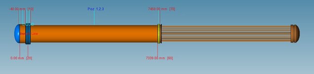

Hello every one , i m newly joined member in design department so plz guide me
How do I change the tubesheet direction, I would like it to be the opposite of the picture. So that the tubes are in the shell.
It's a matter of which node the tubesheet is connected to.
Tubesheet --> tubesheet properties --> element from node --> set the node of left tubesheet flange (should be node 30 according to your snapshot).
Than use f8 and the program updates the displacement of the tubesheet.
