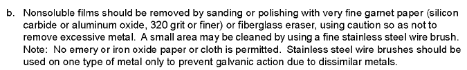

I am working toward USA requirements but the CASA reqs provided additional detailed information - I figured I'd gather the AC 43.13-1B, SAE ARP1870A, and the CASA documents to make sure I covered my basis and didn't miss anything. The SAE document also specifies a wire-brush for aluminum cleaning:
Your description of the process aligns with my understanding and process-write up. I think the area that I have swapped is the abrasive cleaning and the solvent cleaning. I thought we chemically strip paint first and then use abrasive action after to get what did not come off. ?
We have some paint stripper on hand but I'm on the fence about using that on aluminum. I've ordered alumniprep which I think will do the trick after abrasive cleaning. My coworkers seem to agree that the petrolatum is not needed. I may have to specify to our guys not to use the regular paint stripper though.

Obviously paint/sealant stripping is always step #1... by chemical stripper or very low abrasive means to prevent metal smearing [a very real problem with SStl wire brush].
CRES, Brass, steel bristle [alloys] are highly dissimilar to all aluminum alloys... IF fine particles from the brush become embedded in aluminum surfaces they can become a corrosion nightmare. WORST CASE: brushes [also] tend to be used indiscriminately between metals... so abraded particles from one job [EX: cleaning steel of rust/etc] can be transferred to another surface such as aluminum making situation far-worse. Gahhhhh@^%&***^%$$^^%$^%!!!
