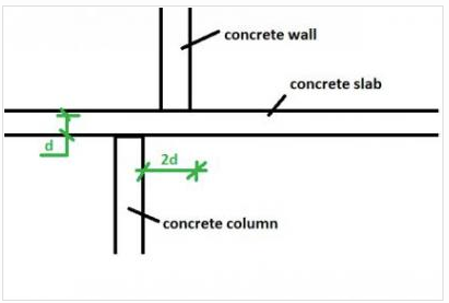

I would highly appreciate any help in the following issue:
Reinforced slab is supported by round column. And there is load bearing wall on the top of the slab (see an image)
For example Eurocode 2 doesnt give any guidance how to take that wall in to a count when calculation the slab for punching shear (for example - how it affects the punching perimeter)?
At least i could not find anything..
Thanks in advance..
